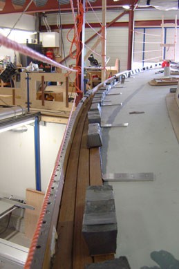

I've seen a picture where the bars are used when making a new teakdeck, but I rather believe that the bars has been use as movable ballast..
Jonas Lissau
Swan 55 - Thyra
Refit of Ellinor (sorry for using your picture!!!!)
