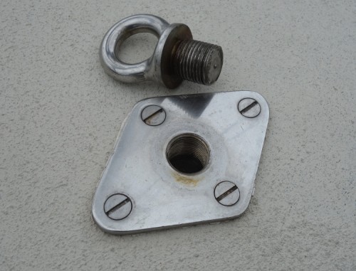

we ran into a similar problem: one of the threaded ringbolts was missing when we bought the boat. I checked with various hardware suppliers ("that size?! Forget it") and came to the conclusion that probably Nautor made them. And I did get a spare ringbolt from Nautor's helpful spare part department.

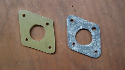

I'm assuming that you (still) have the sunk diamond-shaped fittings in the deck so you could ask Nautor whether they have spare bolts for your boat. If not, you will probably find similar ring combos with the hardware suppliers. The diamond plate is bolted through the deck and is countered with a backing plate below; I did not find any backing plate inside the sandwich deck. However, I found one backing plate that was badly corroded so I replaced the aluminium with G11. I attach some pics.
Hope that helps,
Martin (48/039 Vellamo)
The diamond-shaped fitting with a threaded ring(bolt)
Backing plate below deck -- old and new

I think I have exactly the same fittings. Seems to be a very strange size indeed. The thread looks finer than a normal metric thread. I will give it a try at Nautor. Any suggestion for a standing block suitable for that specific bolt ring?

For attachment to these eye bolts on our 40 I use a Dyneema endless loop and one of the frictionless rings.. easy to splice!!! I use 10MM Dyneema.
As for the deckfiitings: A suggestion...  If you can't get the originals pull the diamond fittings out of the deck and get them re-tapped to an appropriate thread size and get a metal worker to make you eye bolts to fit. I get a lot of custom SS work done.. at the moment mounts for a second set of winches in the cockpit for the code O and A-sym sheets.
