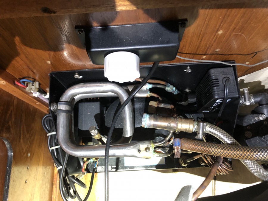

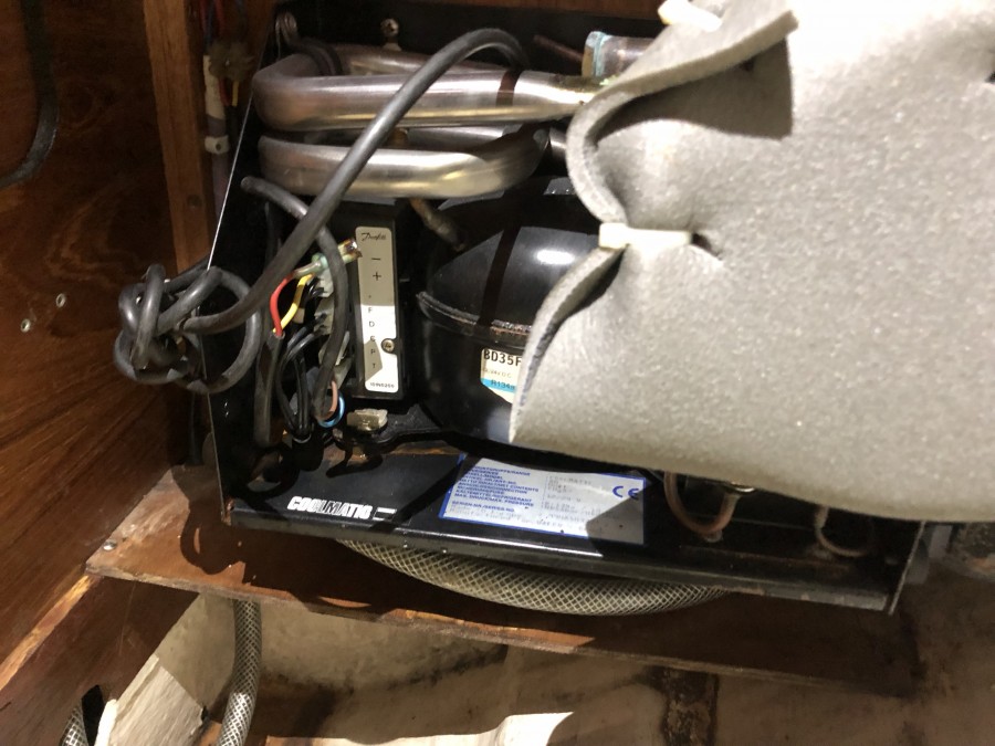

I have water cooled refrigeration unit Waeco Coolmatic in place and I noticed a big problem. Its drain water pipe have rust away because of lost zinc (I assume). Maybe this could be fixed but in that case I would need new zinc.
Has anyone faced same issue and does anyone know a place where to get similar units and possible new zinc. I would like to keep existing water cooled refrigeration unit because it uses a lot less energy than air cooled system. I asume that major of the S&S Swans has water cooled system?

Waeco coolmatic from side
Waeco coolmatic from the top
see rusted pipe

Thank you for your comments and I manage to find similar unit from boat sparepart shop in Barcelona. Unit was unused and few years old. Now it is installed by a boat mechanic and refrigerator works again perfectly. All good again :)
