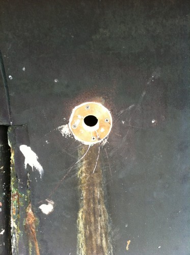

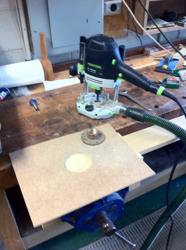

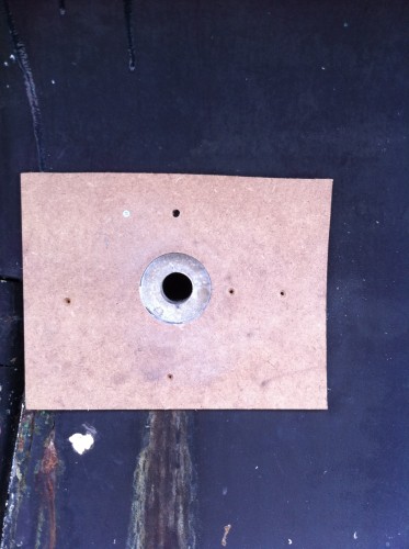

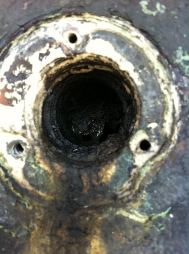

Dear Derek, When I purchased my boat, Swan 43, hull 003, there was a garboard drain plug installed but I was not convinved that it was the origianl. In fact, I was very worried that it might actually come loose and sink the boat so I decided to replace it. You mentioned that you plan to install a drain plug. This is how I did it on my boat. ![]() original drain, without plug, up close - scary ![]() template to cut mortise for new drain plug ![]() template attached to hull and ready for router |

I cleaned the area aroung the original plug area completely;made the template to the exact size of the new graboard drain plug; attached the template to the hull and, using a router fitted with bushings, cut the mortise to the exact depth. I drilled and tapped for machine screws and bedded the new drain plug housing in polysulfide. Below is the finished product. ![]() Garboard Drain Plug Fitted |
