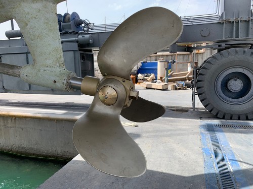

Dear Philip,
in the meantime I tested a the 3B Bruntons. I am not positive.
The speed is not exactly as it was supposed to be (similar to the 4B MaxProp one), but what does not make me happy at all is it is very noisy.
In reverse it is a very good propeller and does not vibrate at all.
...but I usually use the boat in fwd gear! Up to 1,800 RPM, no noise/vibrations, above 1,800 RPM it start to vibrate (quite a lot) and be noisy. I called Bruntons and they assured me the blades have been properly calibrated, so this is not the problem and a technician from Bruntons is coming omnboard next week end , but I will get back my Max Prop, maybe I will swap it with a 3B next season!
More and detailed info after next week end!

18 June 2019 - 10:30
#16
attached is a pic while they were installing it!

Dear Philip and Friends,
after a non satisfactory test with the Brunton, I decided to overhaul my “old” 4B 21” MaxProp and install it back on Vanessa, which I will do next week. As it was in the factory to be overhauled I decided to slightly modify the pitch, which is now c. 19,35 degrees. That, in theory, should give me about 100/150 more RPM at full throttle and allow the engine to be a bit less “charged”, in order to decrease its smocking (difficult task with a Yanmar...!).
I am going to post test results after July 14th.
