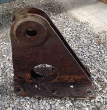

Dear Snowwolf
Could not find photos of Swan 48 lifting lug, but it is likely to be very similar to the one shown below.
If so, the wooden wedges are not required, and can well be removed.
If you have oil in the bilge, either the engine bay is not closed off properly from the bilge, or has flooded at some instance. The recommendation is to keep the bilge free from oil.
