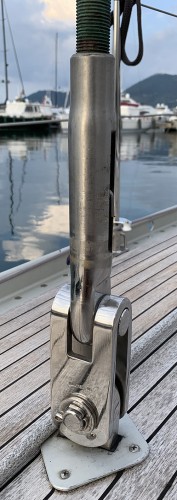

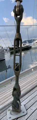

As far as I can see the original Navtec turnbuckles (on rod shrouds, fig. 1) are as perfect as new, and the original Lewmar, bronze (on wire shrouds, fig. 2) are perfect as well.

Lewmar bronze turnbuckle
Navtec stainless steel turnbuckle

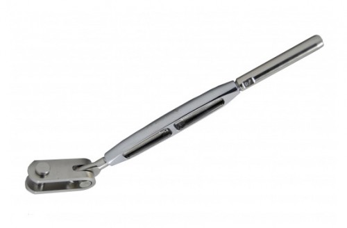

Blue Wave turnbuckle

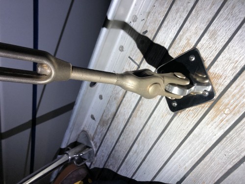

This may or not be helpful , but when considering the rig on Sarabande, I was advised that the original turnbuckles should be replaced ( after dye testing?)by more than one specialist rigger. To me they looked fine and it seemed wasteful to discard them, but that and other areas of rig which was worn led me to consider the complete replacement which ,as you know , is the choice I made. Sheaves, spreader ends and pins were also areas of concern. I now have turnbuckles as in your picture.

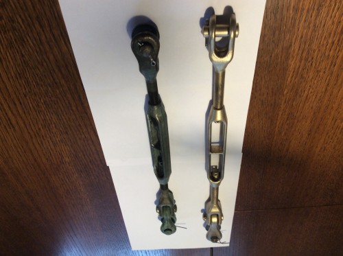

I did some cleaning to the turnbuckels and after cleaning it is quite easy to inspect if there are any damages. In my tunrbuckels there wasn't any damages. I think they look also littlebit cleaner and nicer :) Treatment was done with glass blowing treament.

before and after
also cover plates are new
