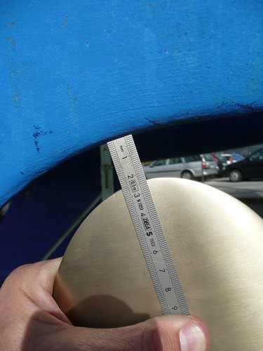

Dear Chris,
this is the clearance (25 mm.) with the 15" Max Prop, three blades, onboard my 38/067 Only You
