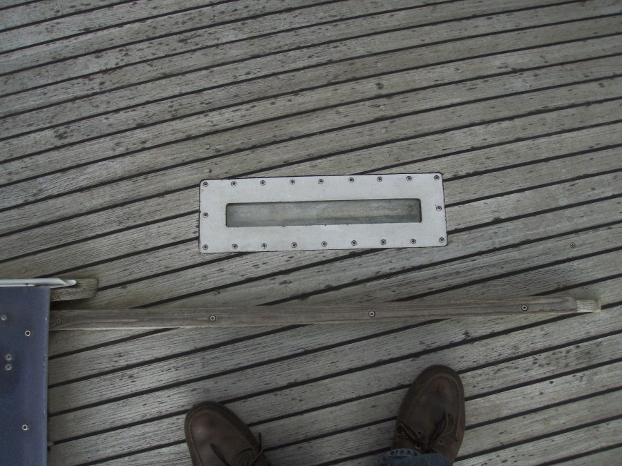

on our Swan 48/028 we need to have a new hatchhandle and its counterpart for the hatch in the front bathroom. I think it is still the original hatch, but I am not sure.
Which brand is the hatch?
Does anybody know where we can get a sparepart or which of the new hatchhandles would fit?
Please see the photos.

Hatch in the front bathroom

Dear Matthias,
it is not the original Goiot hatch, did you check Lewmar?

Hi Matthias
Is that hatch original fit. Snow Wolf doesn't have a hatch in forward bathroom just a light prism.
Your handles look like Lewmar Super Hatch ones that were used up to about 1987.

Here more can be found about old Lewmar hatches
https://www.lewmar.com/node/14692
