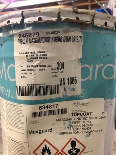

26 February 2020 - 19:18
Thank you Rob!
Yves Le Cornec from Nautor Villefrance confirmed that Ashland TM 66100 H is what they are using. Now I am trying to find a distributor who is willing to sell less than 20kg of it.
Christian 411/028 IF
01 March 2020 - 09:39
Join Date: 01 March 2007
Dear Christian,
Good luck with finding the topcoat, I was told that the catalyst is also tricky to obtain and it is particularly volatile apparently.
The photo is of a 20kg tub of what was left of a job done at Villefranche on my 47 - 2 years ago. I would offer it to you, but it may be out of date according to manufacturers guidelines which might be a consideration if you find it in smaller quantities.
Rob
Sarabande 47/029

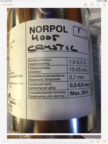

23 March 2020 - 07:00
Join Date: 06 January 2012
Posts: 75
Hi, I just used this one to the bilge and the colour match is perfect!
iHe, Swan 431 "CAID"
27 March 2020 - 18:11
Thank you iHe - where did you get this from?
