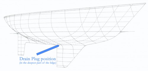

27 March 2020 - 14:34
Dear Serge,
please see even the attached drawing
08 April 2020 - 10:16
Join Date: 22 November 2015
Posts: 13
THANK YOU.
What I see is  only a square with no drain plug.
May be it was clogged on purpose.
What would be nice is to have a picture showing the drain plug in its exact place.

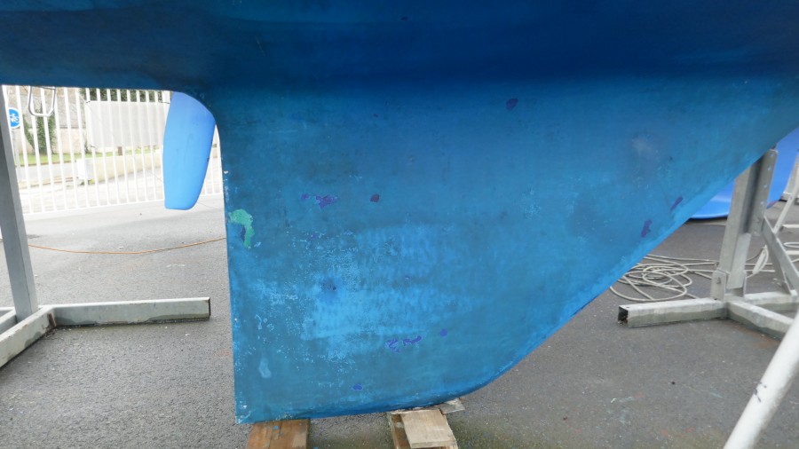

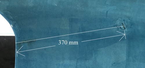

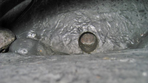

21 April 2020 - 08:28
Posts: 56
Dear Serge,
Attached please find pictures showing the location of the bilge drain plug on Swan 38.
The plug is located on starboard side, between the two aftermost keel bolts.
Jyrki
21 April 2020 - 08:37
Posts: 56
P.S. The two pictures above are of two sister Swans, but I assume the location is identical in both boats. In Infant the plug is faired and not visible outside.
Jyrki
