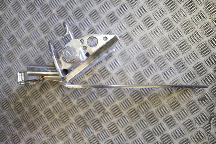

Walidada : I had a Bamar electric installed two years ago. No Hydraulic issues. It has been amazing although two years is not much.  I haven't found any servicing instructions however except a motor resisitance test. I intend to go to the factory sometime (Forli) to ask.
On that note however 5 years ago we found that the stem fitting had bent with the loads of Code Zero and Gennekar on the bowsprit.   It was reinforced and now fine.  Worth a check.
Jonathan.
01 May 2020 - 15:31

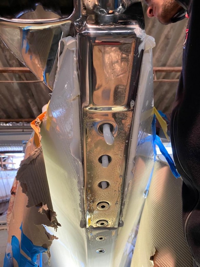

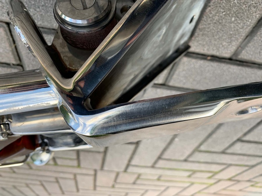

Dear Jonathan,
mine did not, not yet, but I remember you had this problem, so during this last winter (when Vanessa was completely dismantled to receive her new teak deck) I took the chance to double the weak corner with a 5 mm. plate, please see below pics.
Before
After (detail)
During re-installation
