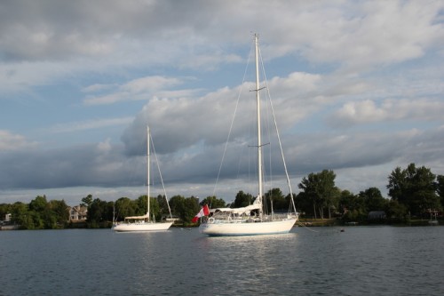

Pete, we have been sailing Swan 47 "Till" for 3 seasons. Last summer we vacationed with our 2 children (6 & 8) and all the sailing and anchoring was done singe-handed.
In my experience, the heavy #1 Genoa is un-manageable for 1 man to carry on board. I am able to deal with the #2 genoa. For racing, I have a #1 North 3Di which I can actually carry alone. This might be a good option for a furling #1 in the future.
The storage space in the forepeak is more than enough for all our cruising needs. There is also plenty of space below the helmsmans seat but unfortuntely access is not ideal.
I agreee with the other comments, having previously sailed a CS36, that the additional workspace on deck gives a superior feeling of security as well as the bridgedeck access to the boom makes folding the mainsail easy.

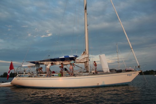

Till at anchor
2 Swan 47's at mooring

your wind socket looks very good (as far as I remember is similar to the "Hiscock" one), could  you please post more detailed images if possible?
thanks a lot!
26 April 2020 - 14:26
I found this old photo, which I shot onboard 65/007 Alpha Centauri in 1999, in Thailand, unfortunately I do not have a higher definition image.
This wind socked, I remember, was very good, and I am planning to have one made for Vanessa!

Matteo, I will post an image once I take one. I searched and I don't have any better ones right now. It's a 3-sided dacron square sock with a square plywood on top. The bottom of the dacron hooks to the hatch sail hooks. Normally I also have a line to direct it in to the wind tied to the forestay.
