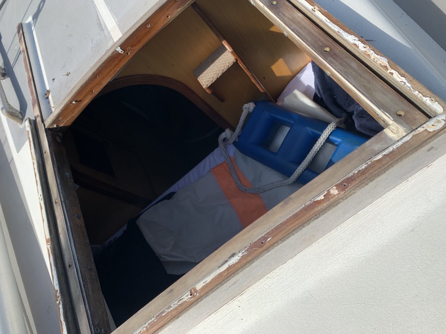

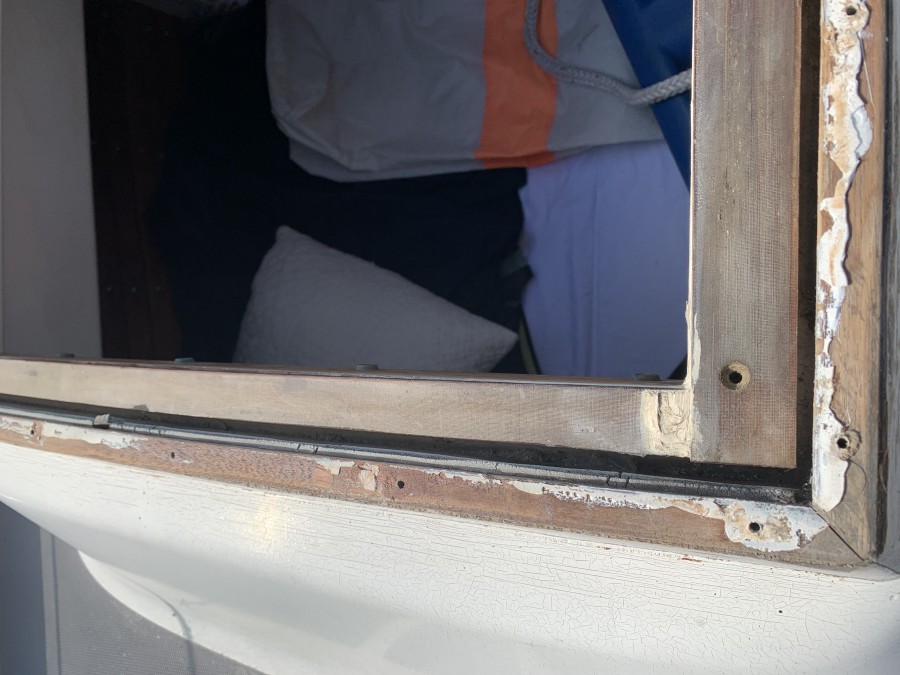

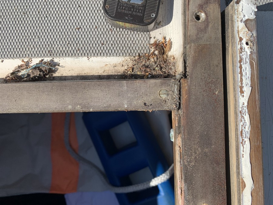

Seems to be really old. Maybe replace right now. Think a Lewmar Ocean Size 70 would fit in a way. Needs some additional constructionwork. Ideas are very welcome. SOme pics attached.

That is exactly the Lewmar model I selected and it fitted well. I have sent photos to your email address since there was something odd that happened with the photos on theis chat.
