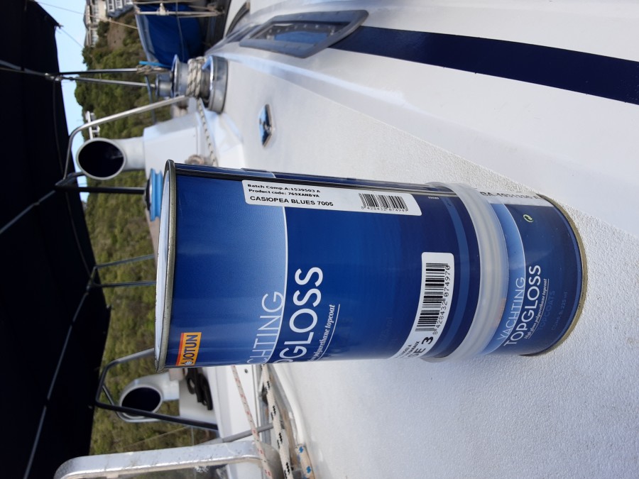

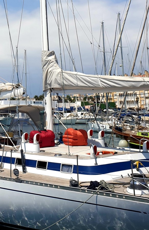

Hello robert,
May this is the right color, same color code than the professor mentioned.
I just did my stripe and dorades two days ago.
It is a jotun two part polyurethane paint.
May that will help you.
