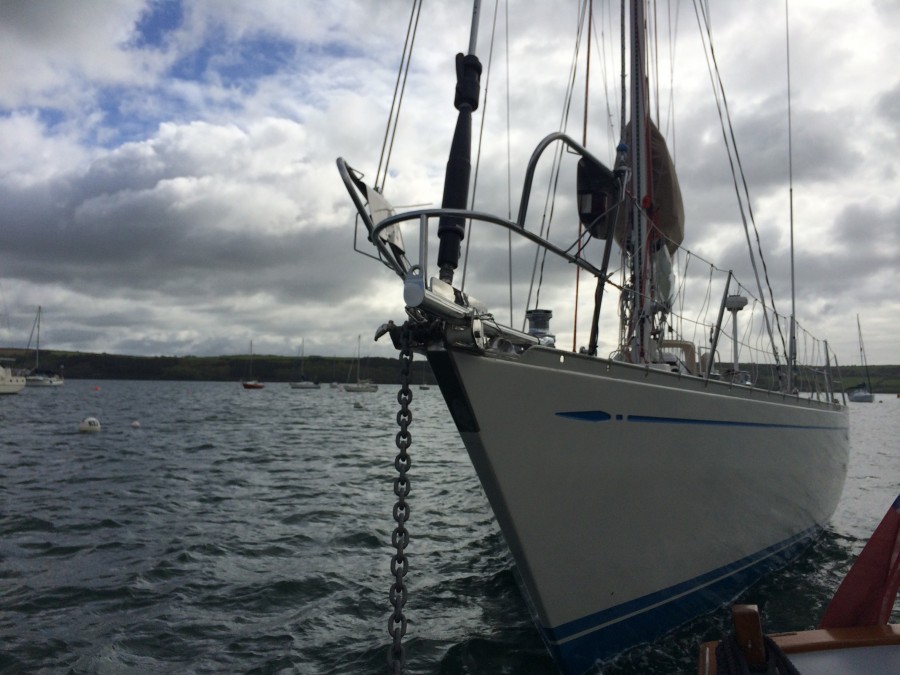

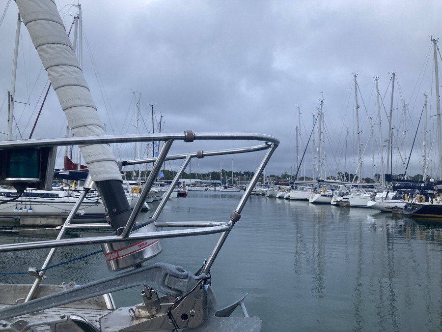

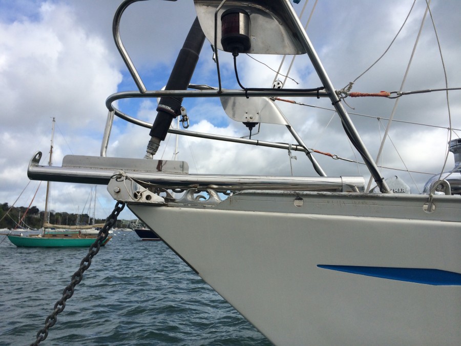

Hi Paul,
I modified the original pulpit on my 47 as in the pictures below. It is a relatively small sprit, our A2 has a full luff length, but have avoided snags on the pulpit so far!

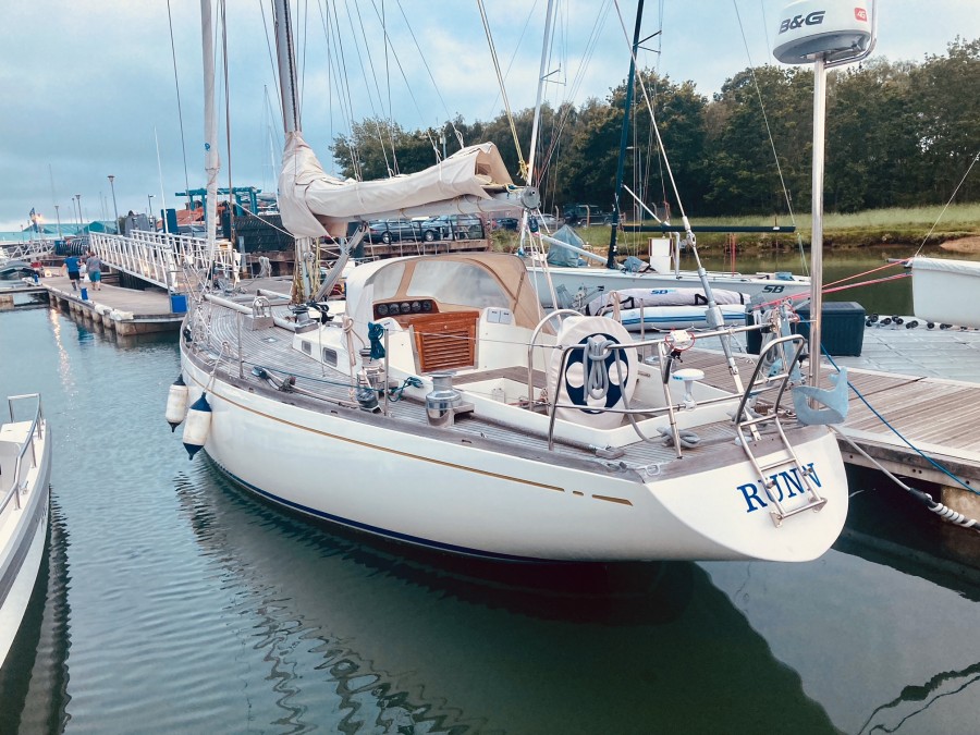

Hi Paul,
We came across this pulpit design whilst looking at RUNN 43/004.
I don't know where he found the fittings but think it's very clever.
Thank you,
Dan
43/059
Removable section
