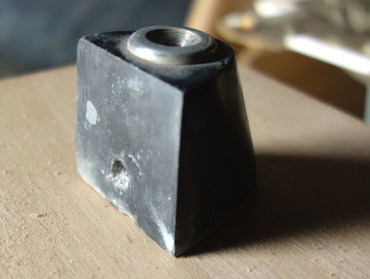

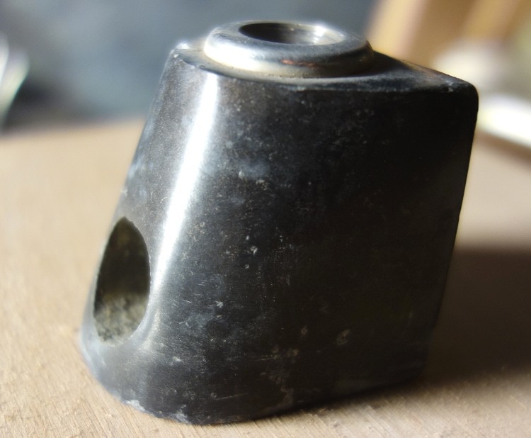

The original parts looked like this, I think ...
The stop is held by two bolts -- a strong vertical one that is sunk into a nut glassed into the aft stateroom deck, and a smaller horizontal one that goes into the X rail. The smaller one is hidden beneath the stronger one.
I found the horizontal bolt to be unnecessary, unless you slam the traveller into the stop; its main purpose seems to be to protect the vertical anchor bolt from bending.
Provided you still have the glassed-in nut: it may be possible to replace the aluminium stop by a teak block. The wood can soften the impact, and it is far easier to replace.

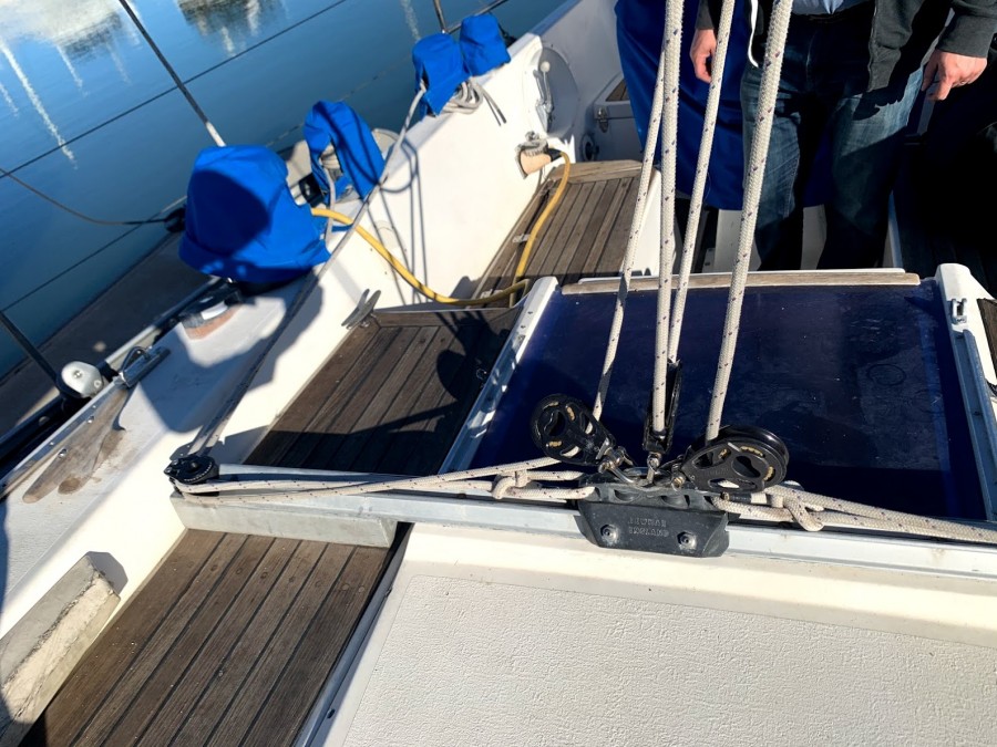

I found this picture from another Swan. Here there is a double block at the end to turn the traveller sheets. There is also a loop on top - maybe for the main sheet block?
Is it a bad idea to try to put both the traveller and the main sheet turning block onto the traveller track from a load perspective?
Otherwise I might have to build a turning block separately for the main sheet.

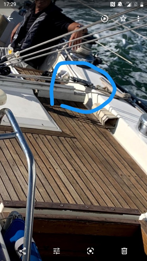

Hi áll,

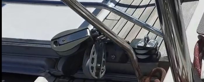

Thanks for the ideas. Wanted to post an update. Ultimately, we managed to find a suitable block from lewmar that fit. We made new holes, and managed to install the block as intended.
So far so good!

Better later than never. I have used the Lewmar 60mm Double footblock on the end of the traveller.
Question: what is the minumum required working load for that block at the end of the traveller? The Lewmar is 200kg working load and 4000kg breaking load.
Will that be enough?
/Peter
05 May 2021 - 18:07
Join Date: 01 December 2019
Posts: 28
Don't know how to edit above post, but there was a typo. safe working load was 2000kg (not two hundred).
I received confirmation that the requirement for traveller end block is 800kg (from Lars on Facebook group)
