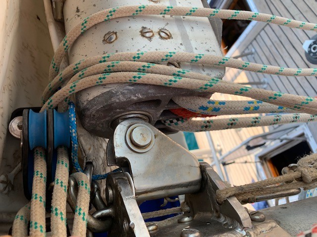

Complication: The boom attachment to the mast, (mastra in italia, not sure in English) shown in pic. is, or seem to work like, the original, when reefing was achieved by rolling the main around the boom. This means that the boom still can rotate around its axis. To keep the boom straight I cannot rely on the rigid vang, but must use it in conjunction with the topping lift. The vang attachment on the boom does not like this and the invevitable play forces open the top connection between vang and boom, and broke it once before.

Thank you Martin for the comment. There is a round pin going through the forward end of the boom, this pin probably has a flange at its aft end, and the recommendation is to look at adding bolts/pins through this flange thereby preventing rotation of the boom.
