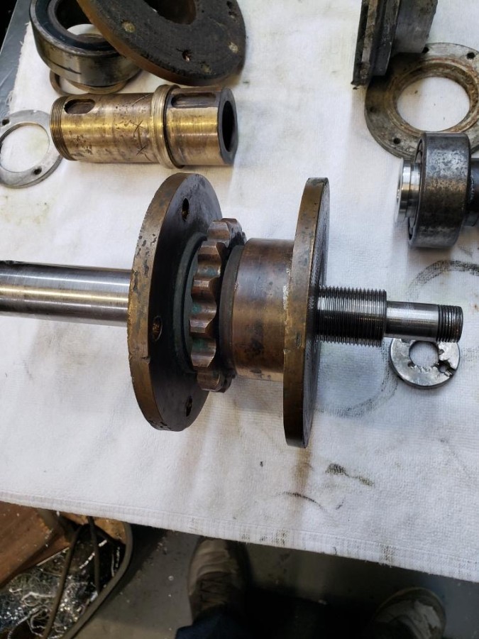

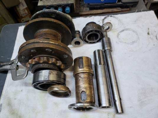

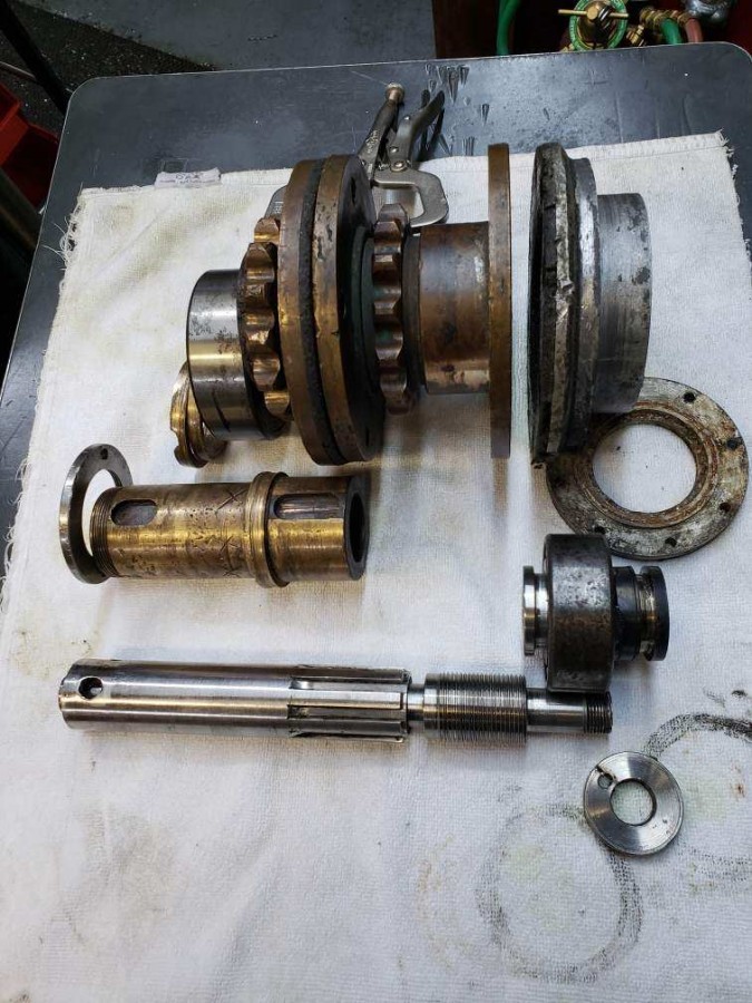

Attached are three pictures of the steering and trim tab mechanism after extraction from the pedestal.  Looks complicated but the engineer who has it says he understands it fully.  Anyway, it's happy news for me.

Two things to consider:  first, the machinist had to weld a piece of steel onto the bearing to get it out; once out, it was clear that a previous owner had removed the mechanism with brute force.  There is damage inside the pedestal that appears to have been done with a hammer and chissels.  It will not affect the restoration but certainly disappointing to see.
