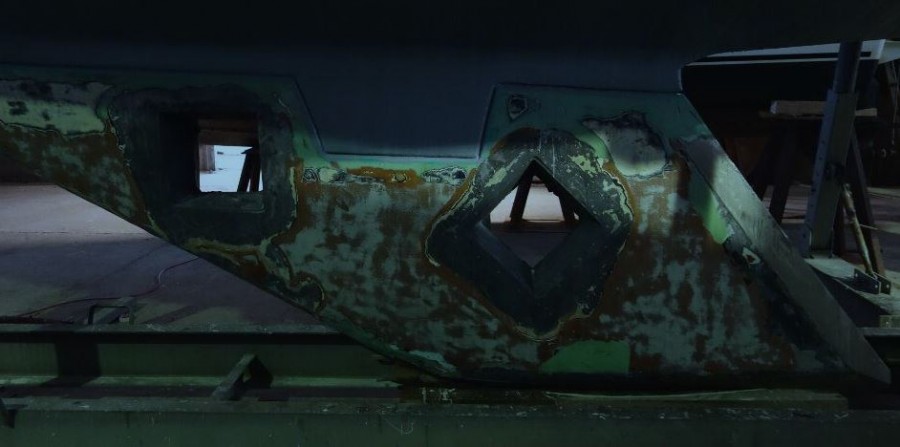

You are right, 011 has the short rig, I = 60.0 ft, and both keel pockets filled. This  indicates that S&S has approved the combination.
The S47 keel pockets are quite big, and were normally empty.
Originally provided for the possibility to trim the bow or the stern down for rating purposes.
