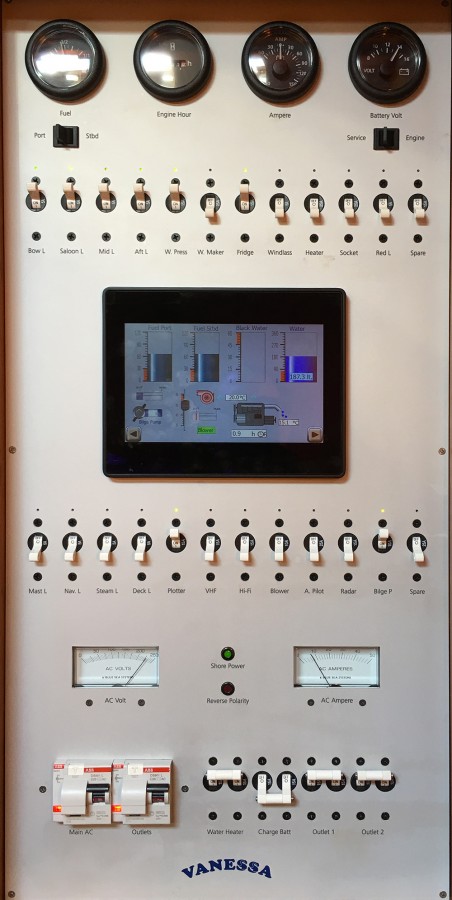

yes they are available (as you can see in the attached pic I upgraded my own electrical panel and bought all brand new switches).
In italy you can find them with Reba (rebadigarbarino.com). I think you can order online.

Dear Matt,
Superb! Your panel (and Vanessa absolutely) looks really great

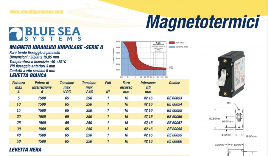

Dear Matteo, would you happen to have (some of) the reference numbers for the white switches you ordered? I tried to find the reba ones but could not access their site so i will need to look for them on other merchant sites i guess? Thank you!
Best,
Matt
06 October 2020 - 19:17
Dear Matt,
from 60053 to 60060 (with white lever), please see attached page of their catalogue.
