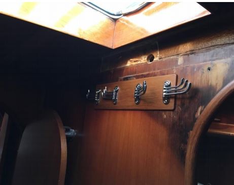

we had some water damage to the centre bulkhead forward of the mast on Kairos when we bought him in 2017. As Lars already pointed out, I'd agree it would help a lot if the source of the leak could be established (or at least narrowed down) prior to the works starting. I understand that water can travel under an old/less-well installed teak deck so the source is not necessarily always above where you found the water damage on the inside.
In our case, we found that the fishbone had actually split in two areas, plus the chaulking needed attention, so it was a good starting point as there were no other obviousl areas for a leak. Luckily for us the fishbone was the source as replacing it solved the leakage for us.

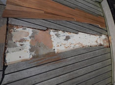

I have attached a few pictures below showing the damage and the works done; it looks that the approach you posted is very similar to what we had done.
Our fishbone and the neighbouring planking (there is always the chance that some more deck needs replacing when you work in an area, I think) were also glued only, no problems so far five years later. The old fishbone was screwed and glued.
Hope this helps and good luck!
Stefan - Kairos (57/043)
Damage below deck fwd of mast
Old fishbone fwd of hatches
Old fishbone removed, new parts ready

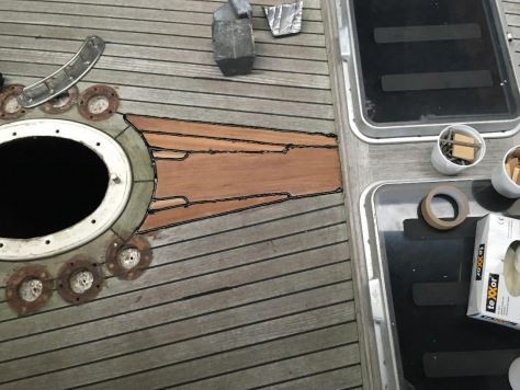

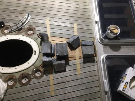

Fishbone fwd of mast being glued
Fishbone fwd of mast chaulked

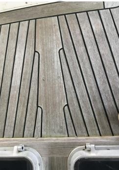

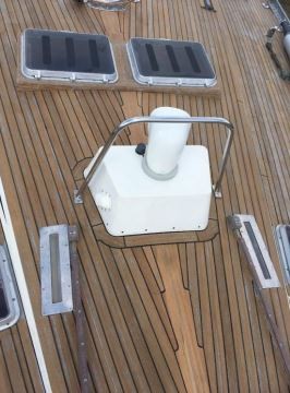

All 3 new fishbones finished, remaining deck slightly sanded
