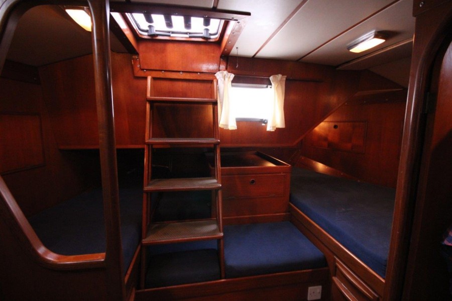

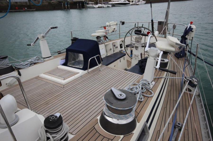

One of Kairos' previous owners converted the aft companionway from the original sliding hatch with hatch board to a fixed, top-opening Lewmar hatch - please see photo below.
We still have the ladder below deck and it is just about possible to squeeze through the hatch but not when wearing foul weather gear etc.
We are currently contemplating to reinstate the original hatch configuration on Kairos, main reason being to have the option to use the aft companionway as direct access to the cockpit in adverse/heavy weather condition.
Believe the aft companionway would be a much safer option than crawling from the main companionwayover what we call 'the regatta deck' with virtually nothing to grab hold off to get into the cockpit as it's currently the case.
We don't envisage to use the aft companionway a lot except in conditions described above as it would likely mean that the after cabin and bunks would get their fair share of water/spray every time it is used. It's pretty much right avove the starboard bunk as you can see from the photo but we believe this is acceptable if (occasionally) required for crew safety.

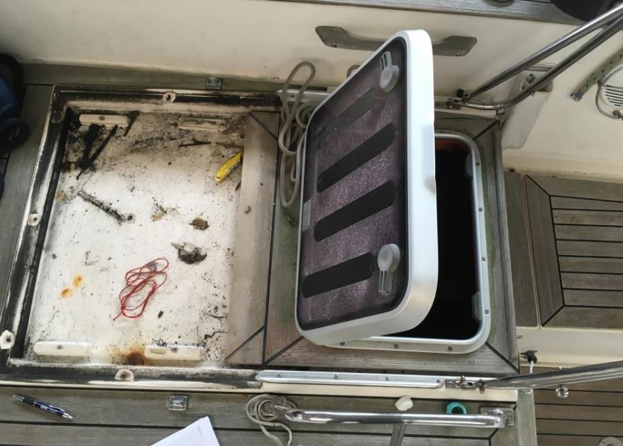

a quick update below - photo of Kairos' aft companionway with cover for sliding hatch removed.
As mentioned before we'll need to build a new sliding hatch and hatch board for the aft companionway. We assume the original design was similar to the one of the main companionway i.e. tinted perspex/plexiglas sliding hatch and teak hatch board?
If anyone would be able to share some photographs etc. that would be fantastic - thank you!

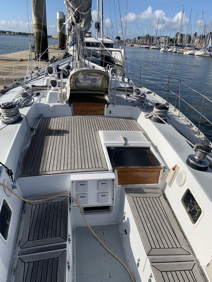

here the original hatch on 57-007 before we start our refit.
we will replace a protection to use it in bad weather too.
fair winds !
yves
algol 57-007
16 April 2021 - 18:38
Thanks Yves,
much appreciated!
So the original aft companionway hatches look pretty much exactly like the ones from the main companionway, that's good to know.
Have you ever had any problems with the hatch leaking? We still trying to figure out why a previous owner felt the need to 'close it off' with a hinged hatch ...

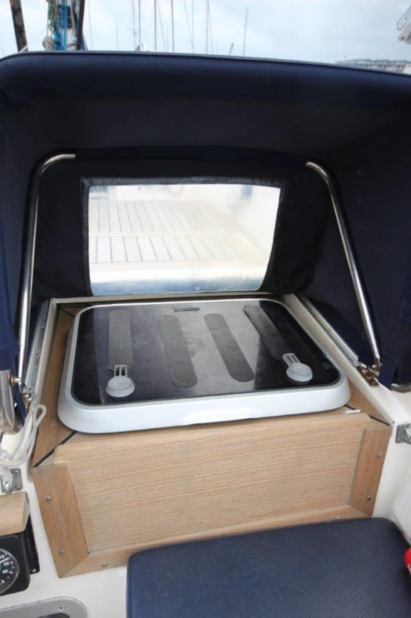

PS: When you say 'we will replace a protection' do you mean you are planning to build a little spray hood for the aft companionway, too? Ours works very well, it's the most sought-after corner of the cockpit as it offers a little protection from wind. It can get in the way a lttle when using our starboard coffee grinder with two persons though. To be able to get a good foothold when grinding it's better to fold it down and stand with one foot on the hatch.

Hi Stephan,
no leaks noted on this hatch, and varnish is good in cabin, so I think there is no problem, and has never be leaks here.
Yes I want to install a little spay hood to keep the hatch opened even on bad conditions, and yes of course it makes a little protection for the cockpit.
I was too searching for maybe a bigger protection for people in cockpit when sailing at night, but yet not found a good and beautiful solution (easily removable)
