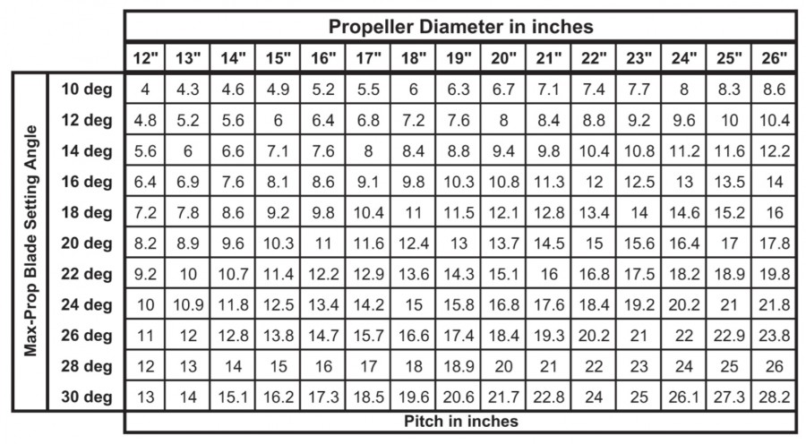

One correction. The pitch is documented to be 12 inches (not 12 degrees), which in 21" 3 blade classic would result to 16 or 18 degrees based on the attaced diagram. Can you confirm?
Anyhow seems wrong, and the obtained speed might indicate same thing. We have never reached 7.8 knots.

12 inch pitch is insufficient, 16 inch needed, i.e. 22 degrees.
