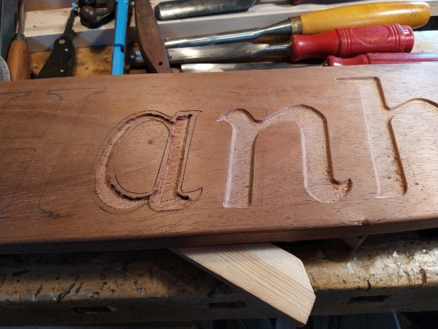

The letters were carved by hand and planed with special hand planes to achieve a smooth and even surface. Due to the gold leafing, the surface and cuts needed to be smooth and flawless.
The letter bottoms also have a curvature to avoid cracking or typical splicing of the O and A letters’ middle parts.

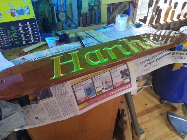

The final fitting was done before gold leafing and varnishing: six layers of diluted Epifanes, which were speeded up by curing with a UV light.
On the first six layers of varnish, the 24 carat gold leafing was attached with French Mixtion adhesive. Mixtion is the best for marine and harsh conditions.
After the gold leafing and Mixtion, the surface was finalised with five layers of undiluted Epifanes varnish, which was again cured with UV light.

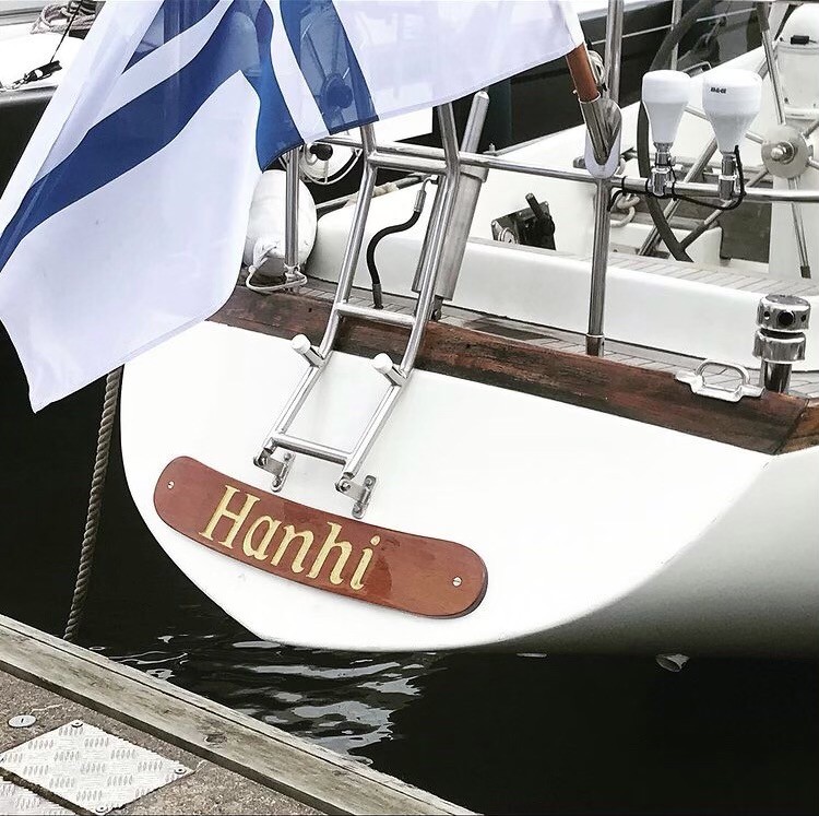

Carpenter and artist Pentti Saares (pentti.saares@gmail.com) is more than happy to replicate the same (or any other wood restauration projects) according to old models and/or hull drawings.
