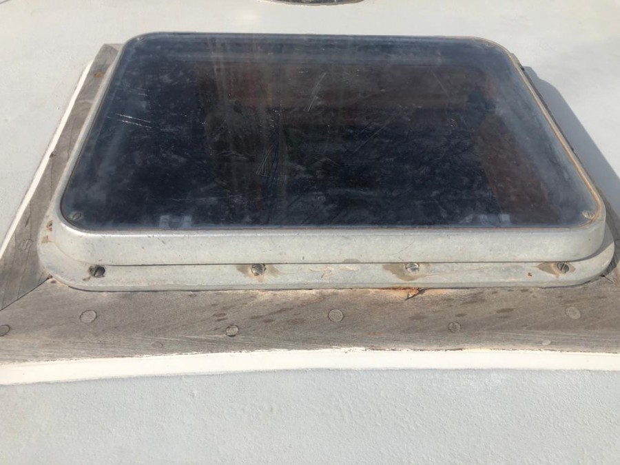

Hello everyone,
Does anyone have any idea what hatches we have on board? If so, are they still available to replace?
We have them on our Swan 44 S&S (1973): RepoMan
Eddy Lekens
Hatch logo
Hatch front
Hatch side

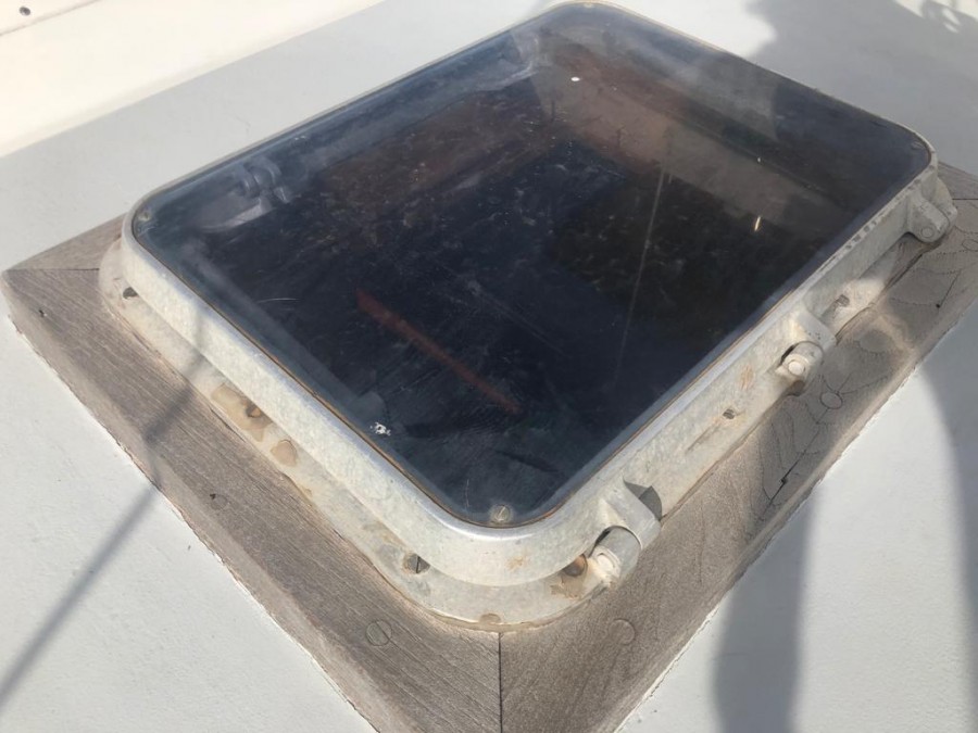

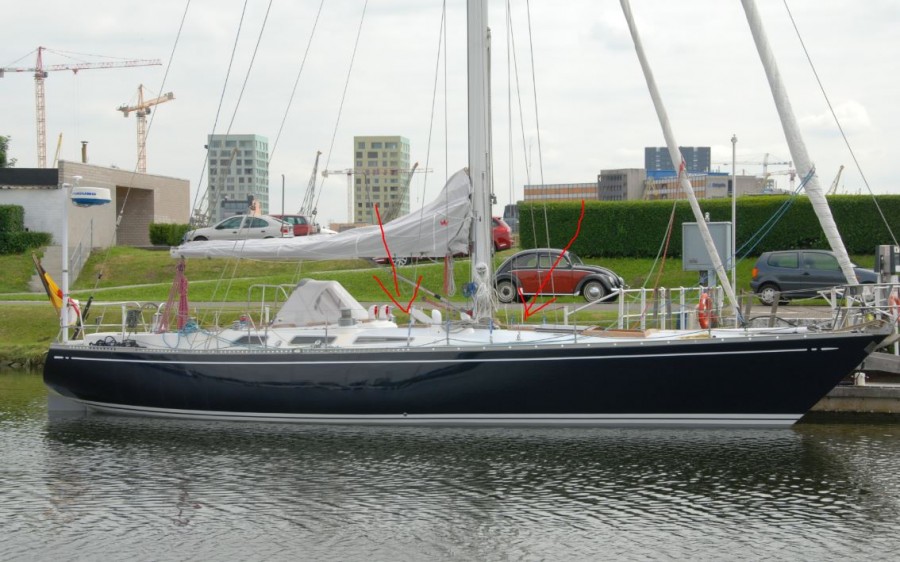

Thanks for the quick reply. No this are the hatches in front and behid the mast.
09 June 2021 - 14:06
Join Date: 27 September 2012
Posts: 38

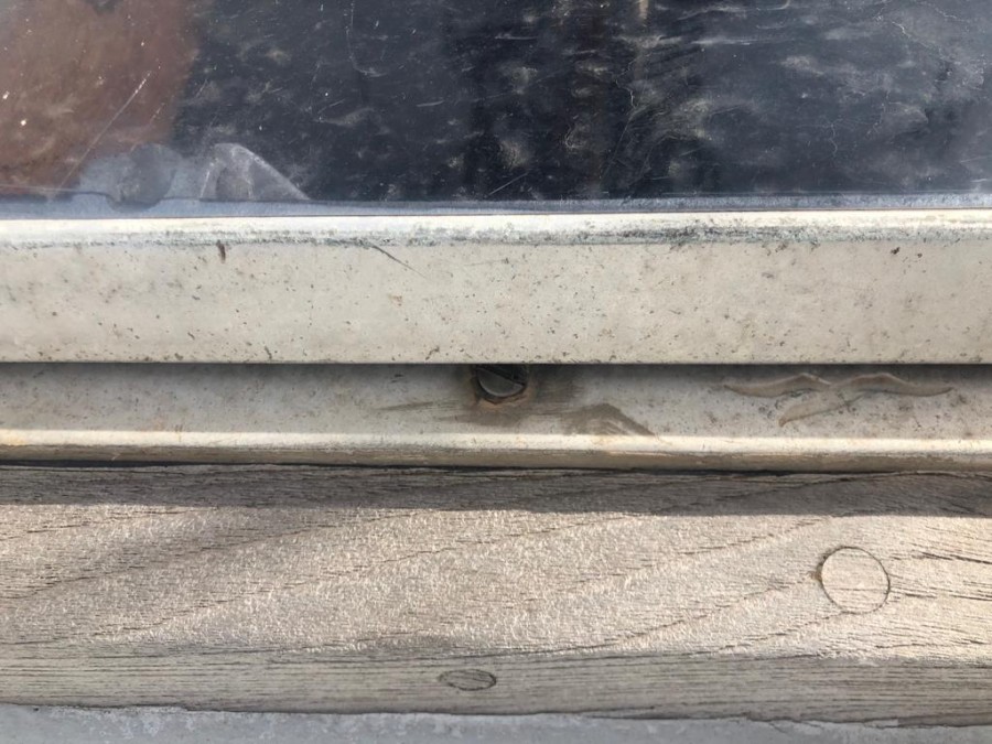

In detail

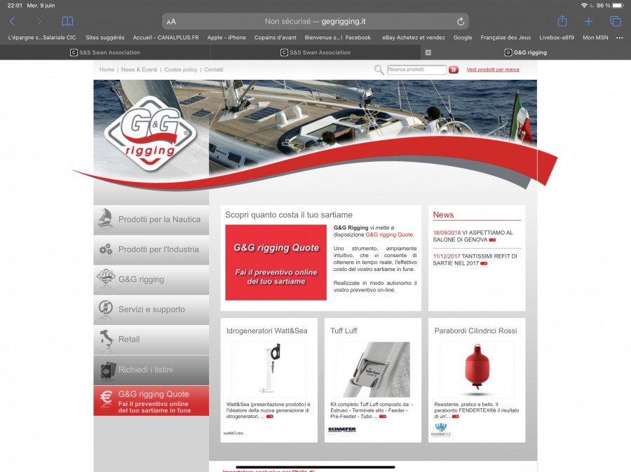

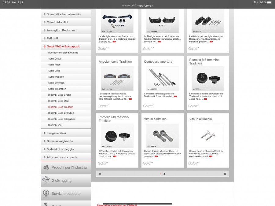

Sorry for my precedent post, the brand still exists and still build hatches,
and it is not Goyot but GOIOT, you can find their website, they have some spare, even old but not much.
the italian company is G&G Rigging, see pictures below, they have more spares for old hatches and can rebuild on command…
