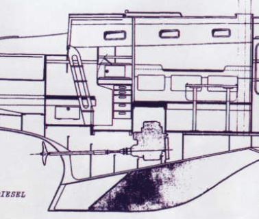

Dear Robert
Appended a detail showing the aft part of the bilge. The bottom of the upper bilge apparently allows water to leak into the lower part, where it begins to smell.
This may be a bad sign - if osmosis is going on in the lower part, and causing the smell, it has to be stopped.
Access from above may be very difficiult, and he recommendation is to cut an inspection port from the side, so you can look into the space, and do what is required.
