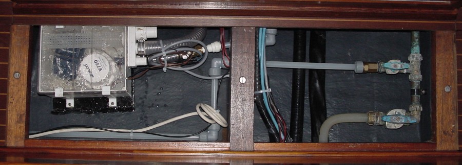

Serafina’s beautiful (no doubt) Baby Blake was removed long before our ownership. The heads basin is ‘plumbed’ into the bilge.  Not ideal.  Has anyone got the same problem and come up with a solution?

if you are talking about the water of the shower,  this is what I did on 38/067 Only You, please see Attwood Sump item on below pic, which worked very well. The pump is automatically switched.

On Infant (38/014), we have the same solution as Matteo had on Only You.
The wash basin drain and shower floor drain hoses are connected under the head floor using a Y-piece. There is an automatic "Johnson Pump Ultima Combo" in a polycarbonate tank placed beside the lifting eye. From the tank the waste grey water is lead to an outlet below the transom.
