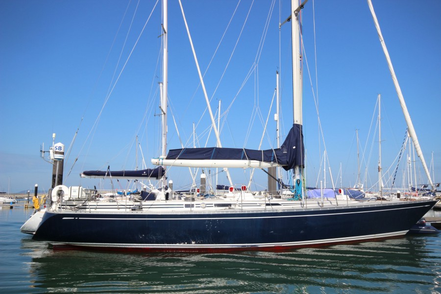

we are having Kairo's hull repainted in February, too.
What I understand from our boatyard is that the paint is not meant to be constantly be in contact with water. I.e. it's not suitable for e.g. the bottoms of cockpit locker where there is some likelyhood of standing water for prolonged time. Apparently the paint will eventually blister if it's constantly wet/submerged ...
The same applies to the waterline, reportedly - when the boat is floating the paint should not be submerged hence the waterline would always be somewhat higher than the water thus showing the antifouling.
We have opted for ALEXSEAL two-component paint but I understand that this is similar for others such as AWLGRIP.
Have attached a photo of Kairos (current/old water line), the waterline position doesn't look too diffeerent, I'd think?
Not sure if this is helpful,
fair winds
Kairos - 57/043
Kairos in Dun Laoghaire, Ireland
