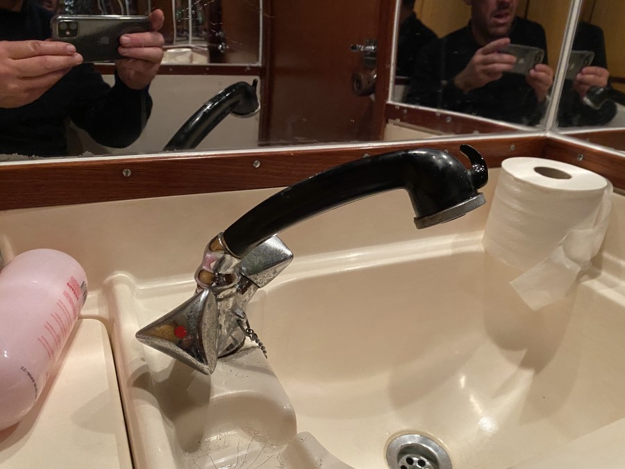

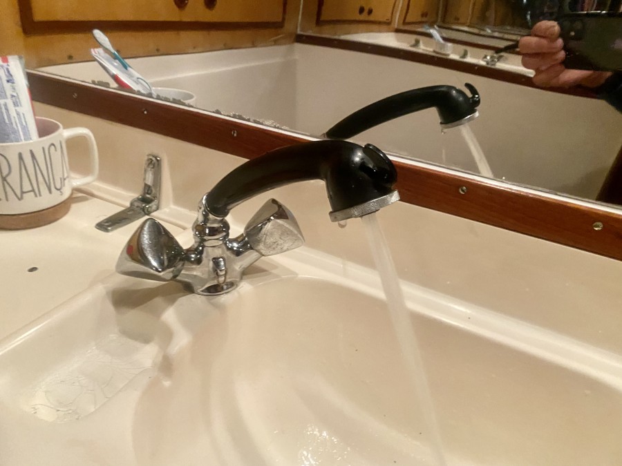

WC faucet (hot water is not flowing)
Galley very difficult to operate. I am looking for a Mixer type

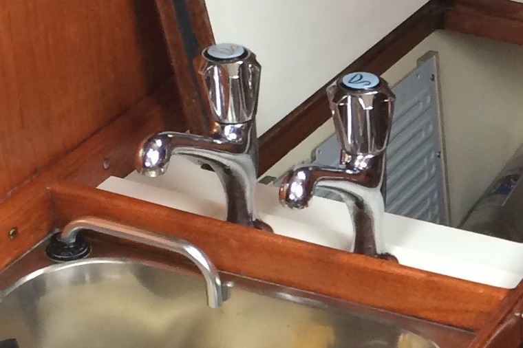

Dear Duarte,
onboard Vanessa I have two faucets, one is still the original, exactly matching yours, and the second one changed by previous Owner and very similar, but definitely not the same quality.
Nautor, in those years, used equipment which if used nowadays will get them bankrupt in two weeks, anyway Owners of modern boat does not look at quality and engineering and design, they want a shiny boat  which will be beautiful  in a Marina (beauty is of course a matter of personal taste…).
This to say before getting rid of old and superb faucets I will try to dissolve the limestone, e.g. putting the faucet in a bucket with vinegar.

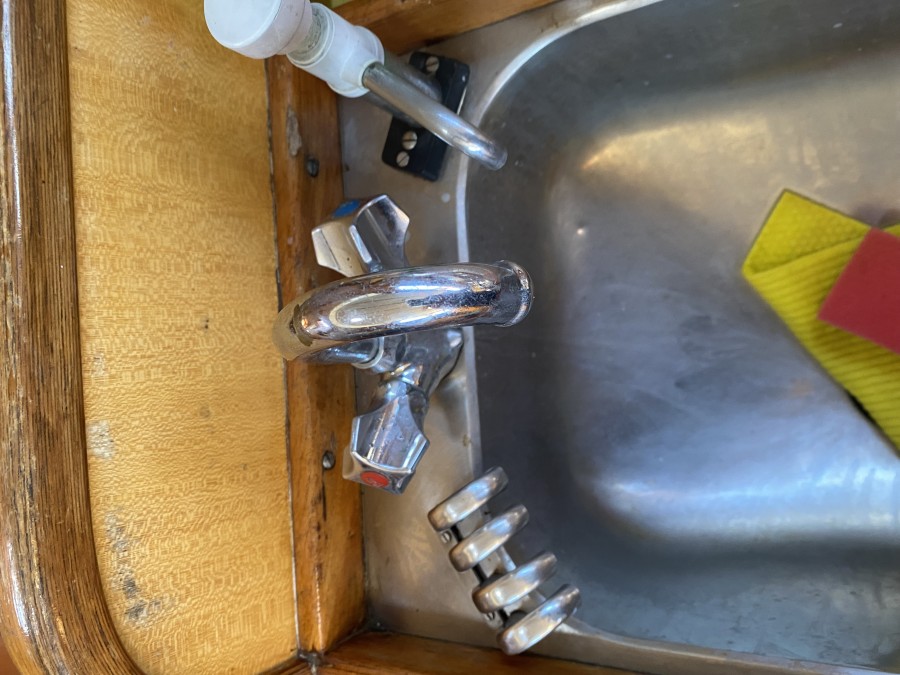

Ill try to do that. The problem I have is that I do not have hot water in the faucet on the WC. I check the pipe and I have water there so the problem is in the hot water handle, which I am not beeing able to disasemble as the small red dot cover seems quite integrated in chrome handle and does not come off in order to change the internal mechanism.

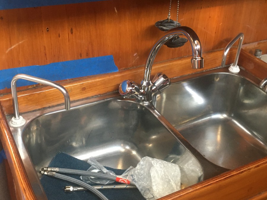

Is the Galley faucet original? It does not seem. I send you the photo.
Again thank you!!!
Duarte (Star Swan)
28 January 2022 - 11:55
Dear Duarte,
it looks original to me. Lars?

Preferably I will try to follow Matteo’s advice and bring the original taps back to life. The only problem is that I do not know how to take the knob out of the tap as there is not any locking screw to take the knob out and reach the valve... (See photo)
Another question is to know the diameter of the connections fittings (female) as in Portugal the plumbing goes for inches and on the boat, it seems a 1/4'' but it’s not. Any special diameter?
The new faucets come with 3/8’’ size fittings but I have male reducers from 3/8’’  to ¼’’ but it does not fit.

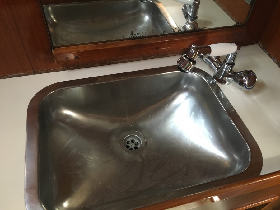

here the new faucet installed by NSGS on 57-007, as I requested...
I must admit I did not check if these were exactly the originals, as the previous ones were absolutely not the original ones...
but they are ok with the boat style and good quality (when new...)

new faucet toilets by NSGS
new faucet galley by NSGS

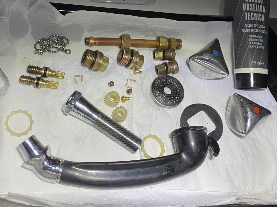

I am writing you to give feedback on my "New 50-year-old faucet mixer".
My currently position is:
36º52'.534N , 001º47'.244W heading Cabo da Gata. The night is quiet and is my shift.
I am currently sailing just with my sister and meals couldn't be better.
Today I wated to give a special thanks to Mateo to motivate me not to change the faucets, "the Professor" for giving me explanations with nice photos on how to remove the knobs out and for all the rest to giving me positive energy to do these jobs and posting.
As so, It took me around 4 hours to restore the original WC faucet as the valves were completely calcinated on the tap and because I could not remove the tap out as there is a plate under where the water pipes go through.
Finally, I was able to unscrew the valves and disassemble them completely. With vinegar and a brush, I clean very deep and after I applied a special marine grease.
The faucet is working PªERFECTLY, I am so so happy to have the original and beautiful faucet working (with hot water now) that although it seems a small and easy job, far from it believe me, It just gave me a nice story to remember every time go to my Star Swan WC!

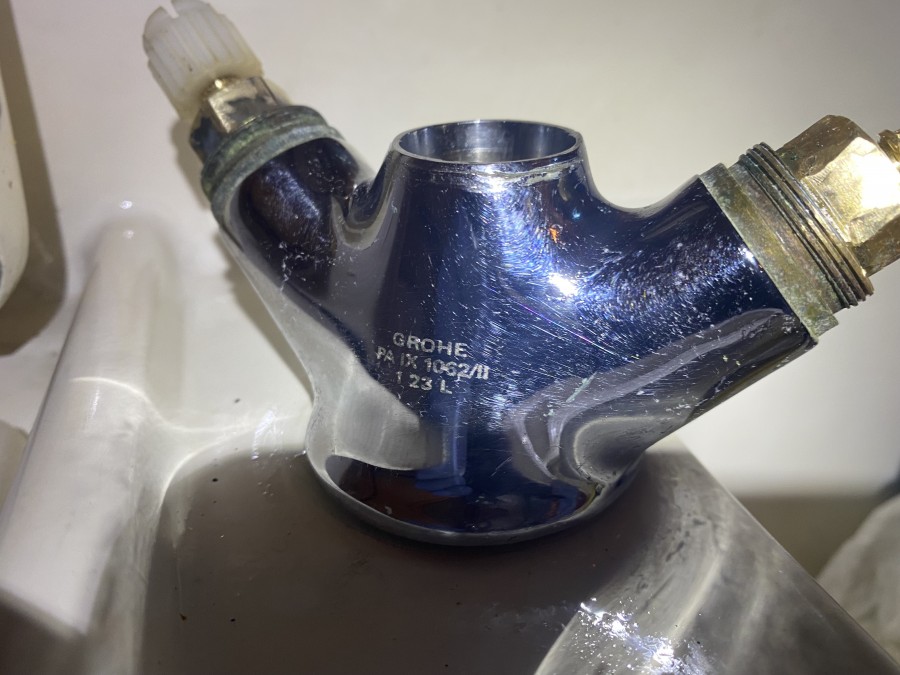

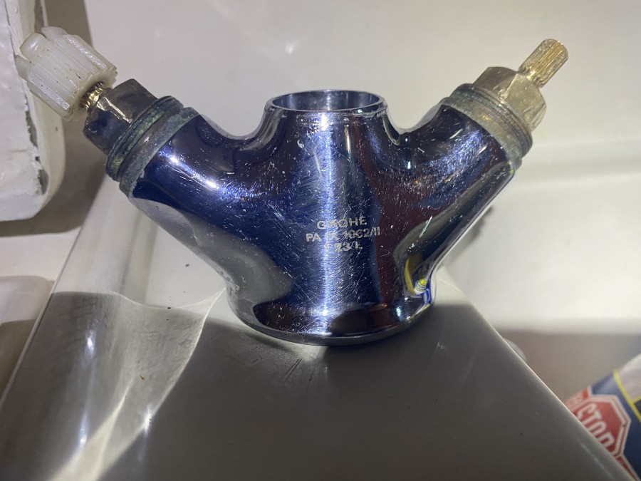

By the away, behind the faucet I found a small engraving with the brand and model:
Brand: Grohe
Model: PA IX 1062/11    123L
