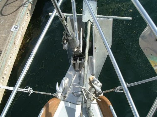

Dear Nathan: Attached is a picture of an anchor roller I crafted for Cygnus. The anchor in the picture is a 35 lbs Danforth Hi-tensile. I found that it holds better in soft mud than my 35 lbs CQR but the roller is wide enough to accept the CQR and the pin hole you see accepts a pin that goes thru the loop at the top of the CQR. Hope that helps. Pete Lange

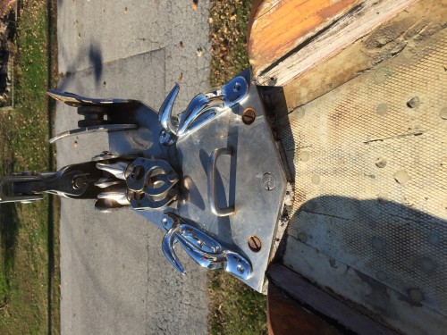

27 March 2016 - 20:37
Join Date: 25 April 2012
Posts: 14
Bow roller, and anchor type:
on our 41/022 we have a 20 Kg Spade anchor, and 60m of 10mm chain. The lot works really well (tested to more than 50 Kts in a thunderstorm, bottom was soft sand and weeds). The shackle is a 10mm Wichard with a V head screw rather than the standard type, so the overall width is similar to the chain.
Only modification: we added two stainless steel flanges screwed to the original ones, against which the anchor is resting, and allowing for the front axle to also sit higher. Can send pictures if you are interested.
Fair winds and kind regards. Philippe.
Can you send me the picture? I am thinking of buying a spade. Thank you filippo

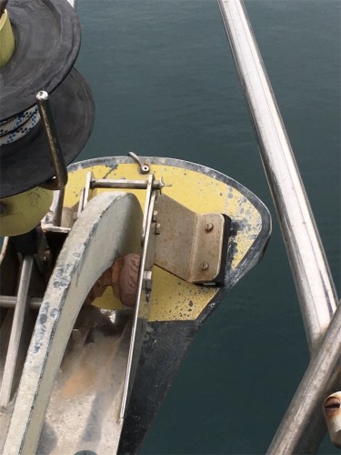

26 April 2016 - 11:46
Here are the pictures.  can also send you a drawing of the stainless steel stops  which are bolted on each side of the original stem pieces.
Hi Peter,
Thanks for the picture.  Does your anchor hit your chocks?
Chris  Mabel's Casse Tete 43/003

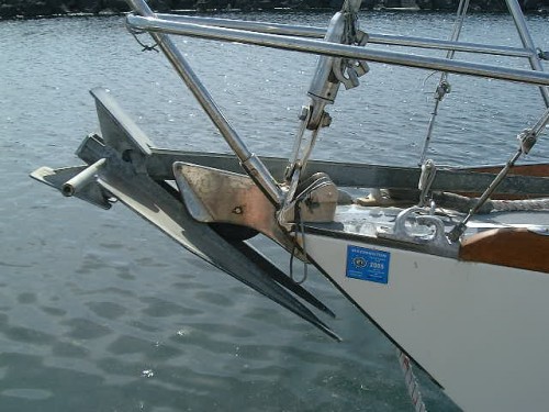

27 April 2016 - 23:45
Join Date: 31 July 2007
No, it does not! Attached is a picture

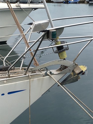

28 April 2016 - 00:57
Dear Peter,
Thank you for posting the picture.
The Professor has a solution for me which requires a new bow roller.  Here is a picture of the newly purchased chocks sitting on my deck.
Fair Winds,
