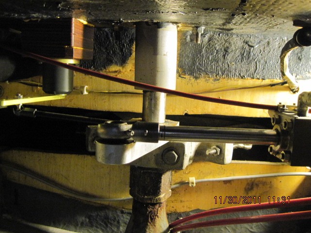

You probably don't want to hear this because it'l cost you money: Your autopilot must be able to handle your boat in high winds and seas sailing downwind. To do this it must be powerful enough to move the rudder hard over to hard over in 8 (eight) seconds or less. It must be a hydraulic ram acting on an arm on the rudderstock independent of the steering. Your wheel steering system just trails along without any load on it.(make sure the wheelbrake is loose) There are hydraulic power units available for about $1,000.00 made in the UK. They have an oil tank, a pump, a motor and a ram and you can install it yourself if you have some skills. I would suggest you go with a B&G controller because it adapts to the sea state. I did and <sailinguma.com> did. When sailing conditions are nice any autopilot will work but when it gets stormy and you are exhausted your autopilot must steer your boat! Don't go cheap on your autopilot unless you never plan to sail away from land much.

Just adding pictures: one showing the installation on my boat, the other one sunning myself on the mainsail while boat is sailing on autopilot and yes, there is a vang set on the boom.
Hydraulic ram installation

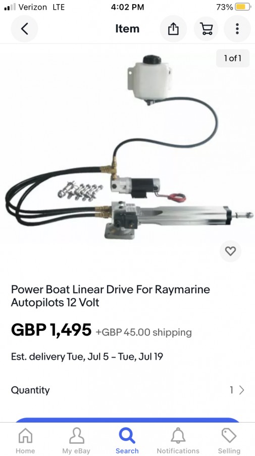

Doing a litte research on the internet and talking to friends i found the following:
https://pelagicautopilot.com/products/hydraulic-linear-actuator-heavy
and:
