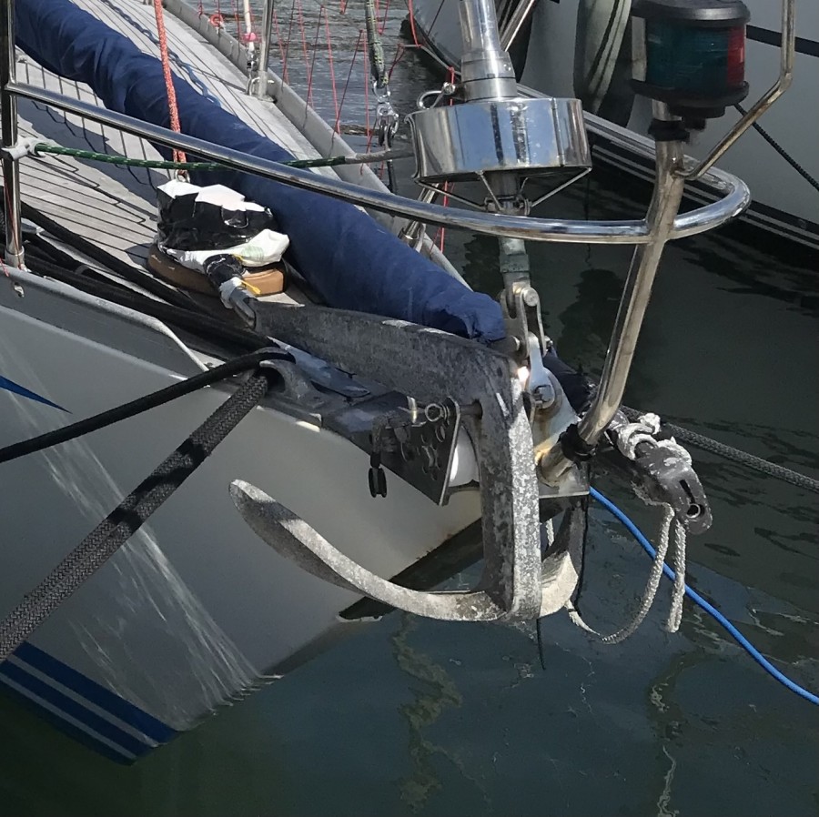

While we know that the windlass chain hole drains into the chain looker and chain locker in to the bilge, when we set off in 25knot in large Biscay seas upwind, i was surprised how much water comes in. (Not that surprised after thinking about how much time the bow spent slicing through the waves effortlessly and the pressure that would create!)
Have other owners devised a ‘cover’ or solution to stop the water ingress while sailing?  Currently we have a plastic bag, duck tape and sponge solution that works but isn’t pretty!!

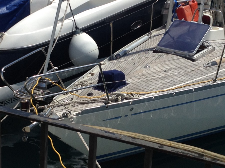

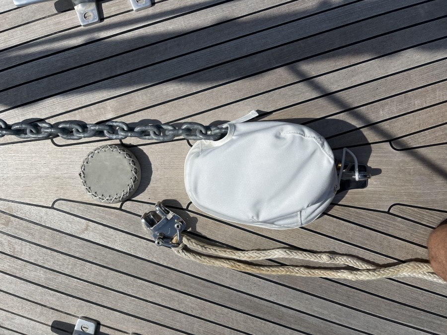

Hi Ben,
a tight Sunbrella cover will stop water  (attached is a photo of the one I have now on 47/069 Vanessa, and I had the same on 38/067 Only You), never had a single drop of water coming in.
Will try to get better pics in a couple of weeks.

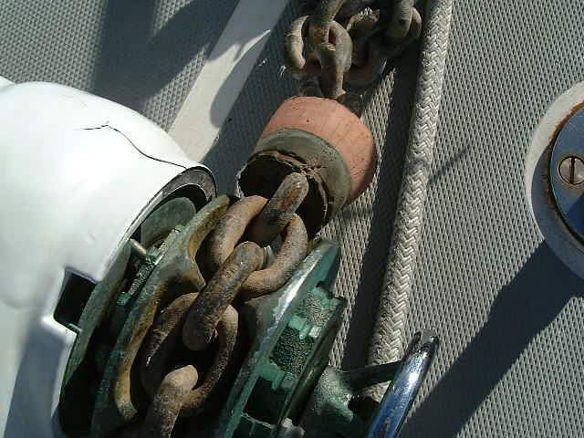

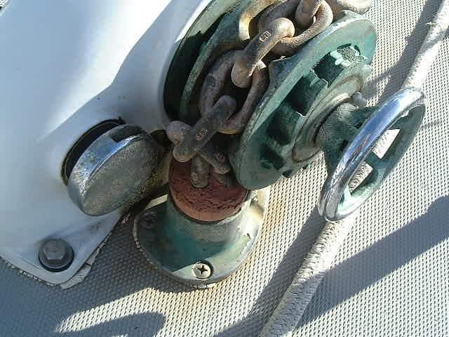

This is a solution Gary Stevens, a friend of mine, came up with: The plug is made from 5200 sealant and a small (just the right size) paper cup is used as the mold. The 5200 is viscous enough so that it stays in the cup when the cup is around the chain.  I have used this for at least 15 years and the plug is still good after many anchorings. It actually surprised me.
Plug out
Plug in and watertight

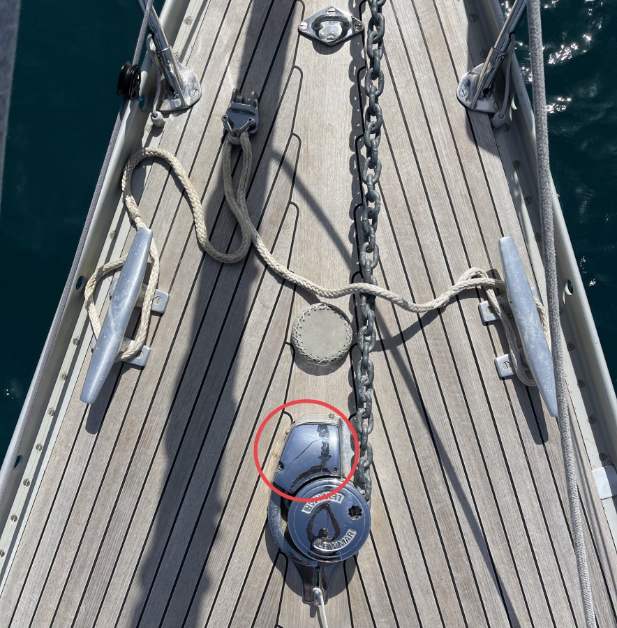

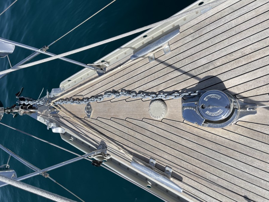

20 June 2022 - 18:36
Posts: 46
Hi, I had a sailmaker in Las Palmas make a cover which is screwed to the deck and open/closes with I zipper, see the enclosed pic. I had it made back in 2013 and it still keeps the bilge (relatively) dry.
all the best, Terje.
