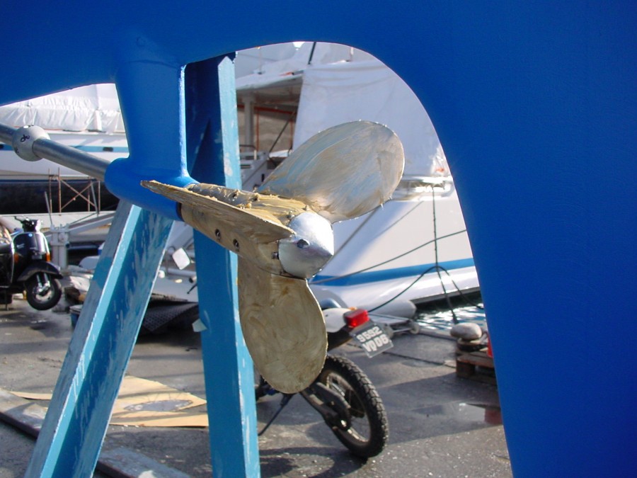

On my 38/067 I had a MaxProp 15" (Engine Yanmar 3YM30) after some bad experiences with a 4-B Flexofold. Max Prop -to me- was the perfect propeller for her, nearly no vibrations, which means less noise and more comfort when motoring. The 15" gives you a better clearence than the 16", you have just to rise the pitch to get same performances. Max Prop are very good in reverse. Post sale service is good and cost one third than Gori.

Hi Ben, hi Matteo,
we changed our feathering  three-blade propeller on CARISSIMA 38/69 with a feathering four-blade prop two seasons ago and we are really happy with it. We run a Yanmar 3YM30AE, 29 hp. Gear ratio forward / rear: 2,21 / 3,06     2,62 / 3,06. Even mannoevers in narrow harbours under strong windconditions are easy to do.
Yes, Matteo, it needs a bit of experience and strong commands on the throttle.
The prop: SPW VARIPROP Drehflügelpropeller, Typ: GP107RH,  4-Blade, Ø 15“ = 381 mm, Steigung:  voraus: 11“, rückwärts: 12“, Konus: 30 mm / 1:10 gem ISO 4566, Nute: 8 mm, Gewinde: M20x1,5, Länge der Nabe: 135 mm, Länge der Nabe plus Anode: 170 mm, Material: Nibral.
Kontakt + information:  www.spw-gmbh.de
Measurement: Distance: Propeller incl. anode — skeg: 160 mm, Distance: Propeller blades — hull: 9 mm (sounds narrow, but it´s OK!).

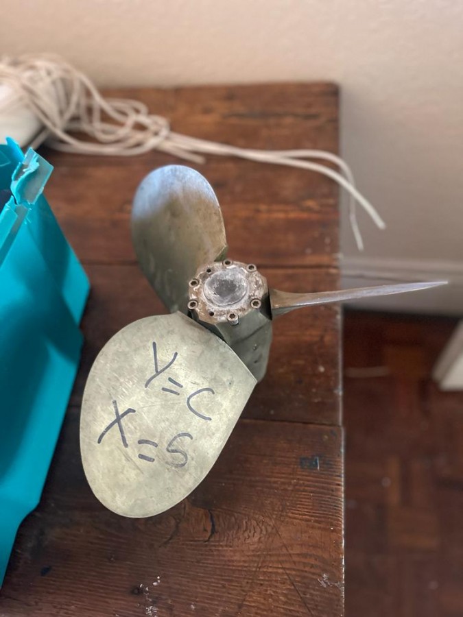

We have just collected all the equipment from the previous owner and discovered that we have inherited a three blade prop.
The Engine is a Bukh Prima 30 HP Diesel.  What is involved with swapping the prop over. I imagine that the pitch needs to be reset or may be different as the gearbox has changed since this prob would last of been used?
As I said, I have no experience on changing a prop so any advice on where I need to start with this is appreciated
Many Thanks in Advance.
Ben
prop

Dear Ben,
it looks a Max Prop, you should ask them (lorenzo@maxprop.it) what is the suggested pitch for your engine/gearbox.
01 July 2022 - 19:25
Join Date: 06 February 2007
Hi, Ben, "toge" has got the same engine as you have and we have changed from a two blade prop to a three blade max prop some years ago (today we run a four blade SPW prop which to us is even better than the three blade max prop was). But the max prop you have got will do!!!! Get in contact wirh your local maxprop  dealer. They are very helpful. They will ask you for some data to calculate the pitch. Then just mount it and be happy. Drive forward in good speed, stop the Bukh, wait half an hour before going reverse and come out in even better speed some meters more to port. Wait for a windy day, that will increase the fun!
