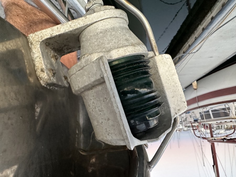

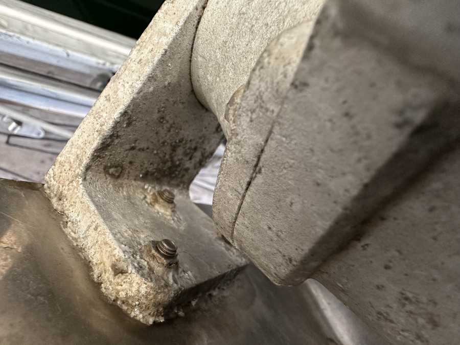

05 September 2023 - 22:30
Join Date: 01 December 2019
Posts: 28
Hope the photos upload.
The lights are great but have not been able to open them to change the light bulb.
06 September 2023 - 06:31
Sorry I misanderstood lights for port lights.
To dismantle these Goiot nav lights you can try to heat them, be careful of course not to overheat the glass, wwhich if I am not wrong it is screwed, Yves (57/007 ALGOL) should know better than me.

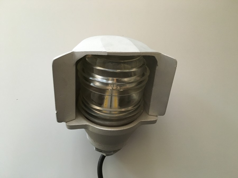

14 September 2023 - 19:22
On our boat we just have the Goiot stern light left. I managed to unscrew and disassemble it, but this took some time and effort. I had the housing glass bead blasted, replaced the cable, and replaced the bulb with an LED. I also made sure that no water can get behind the glass, but do not remember how I did it. Seven years later it still looks good and works fine. The glass bead blasting gives it a nice shine, and provides a better result than sand blasting.
