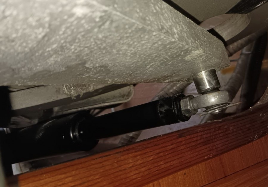

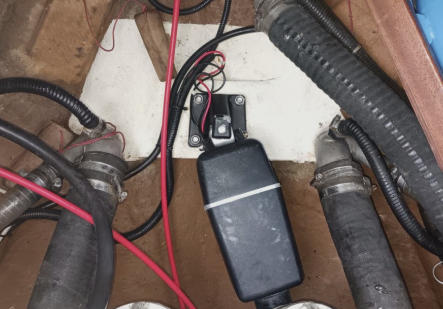

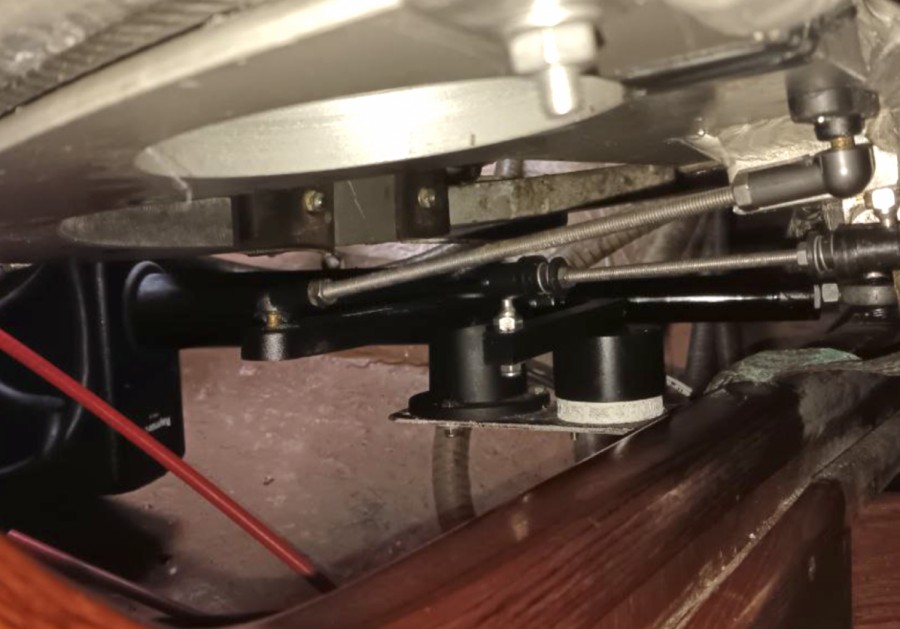

Hello John, Sue and Jon,
10 years ago we installed an Autohelm 6000 Liniar in our SWAN 38 Jacaranda. The space is very limited, but with some modifications, it was possible to fix it in the space available. The system has been working perfeckly. If you need some pictures  from the installation, I can send the in a couple of days.
Jorgen SWAN 38/59 Jacaranda
22 October 2023 - 10:52
Join Date: 06 July 2022
Posts: 5
Hello John and Sue,
On Madeleine, 38/087, there is a Raymarine Type 2S. It fits nicely (upside down).
Sincerely,
Michel
