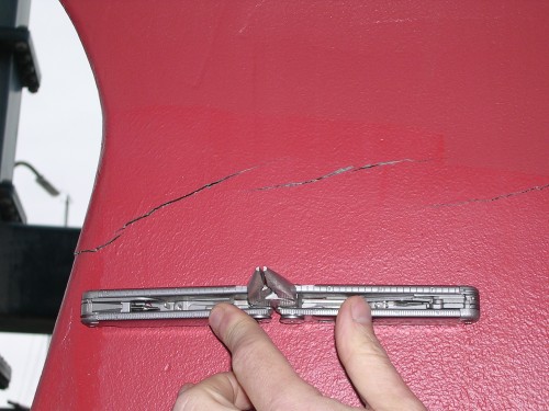

I remember I already contacted you ( about one year ago) to talk about  this problem  which I found on my 48' (Clarion of Skye). I fiilled the crack with filler and after around 1500 miles ( from UK to Italy) when I hauled the boat I didn't see any "moovement"  where the crack previously was untill we put the boat on the cradle.  Then the filler cracked again , even if less than the previous time.
I attached here the pictures taken one year ago
No rust is coming out of the crack but it is very difficult to check the inside because  of the mast step and water tanks.
I have also been told by a UK surveyor that old S&S have this problem because the aft and fwd part of the keel is too thin to have bolts close to boths ends. Do you think it would be better to take off all tanks and check all bolts carefully?

It should be sufficient to check bolt tension only in the area where the cracking occurs. In the picture it is the aft end.
It is correct that the trailing edge of the keel tends to be so narrow that the aftermost bolt is some distance away. If tensioning does not help there are other possibilities, but they are difficult to add to an existing keel
