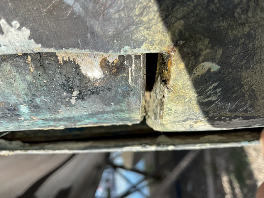

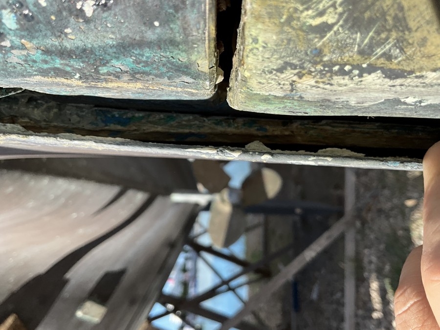

Hi guys. I examined my rudder's Skeg and the outer layer of the skeg seems to be separating from the skeg. It looks like the whole outer layer to be in one piece and all intact. was the skeg made this way in two pieces? Does anyone have this problem or know what is happening. I have shown it to some repair men and they do not know also is it dangerous to sail the boat in this condition?

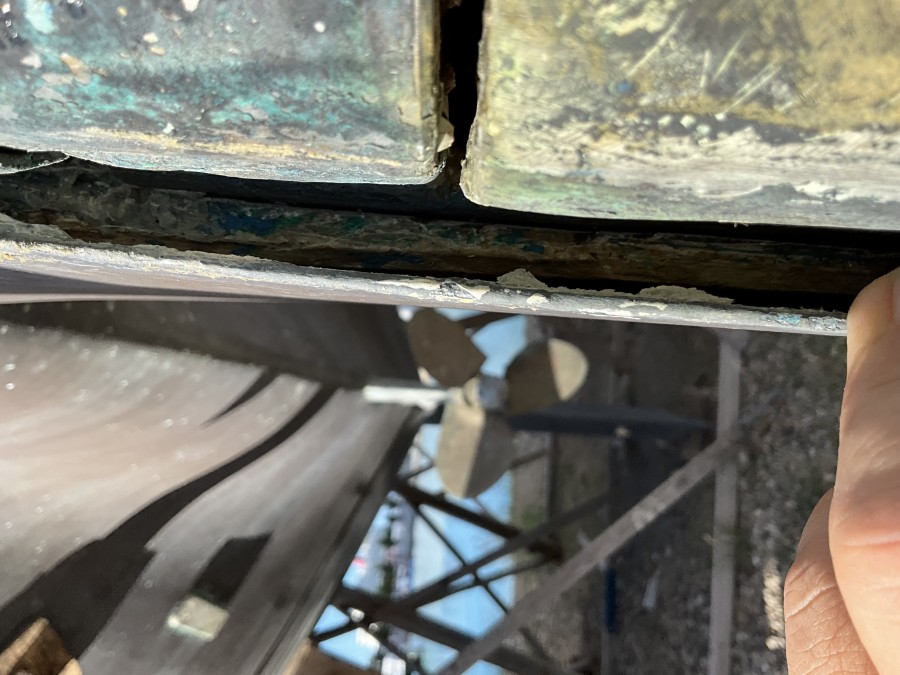

Hi Matteo. I have uploaded photos. Some repair men suggest cutting it at the bottom half where it has become loose and reattaching it after repair. Others suggest to drop the rudder and repair it that way. Thanks.

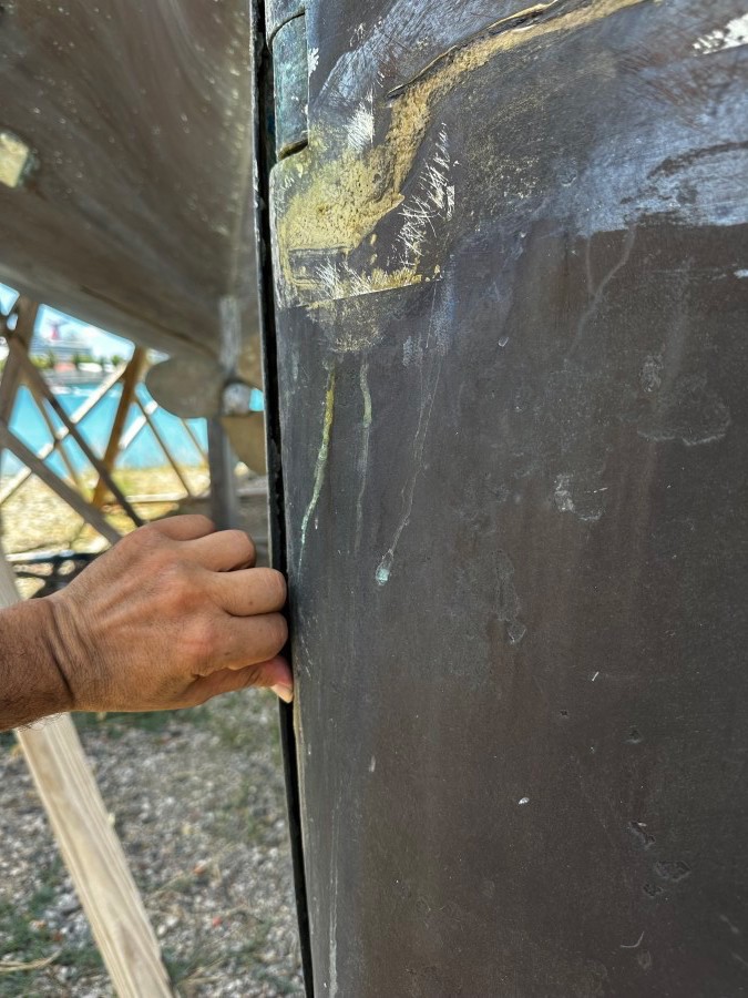

Hi Matteo. The photos I send for some reason are rotated 90 degrees. I have mot photos fjor you from a distance. If you need any more let me know please. Thanks.

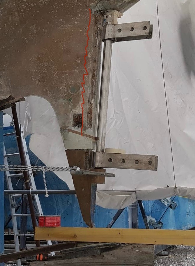

your finger is touching a flexible piece of fiberglass which is just a carter, just to give you an idea, look at the attached pic, of a stripped skeg, where the piece has not yet been attached (but you can see the holes, as it will be screwed).
Lamination on the rudder does not look so good. Or is it just the  photo?
The skeg was built in two pieces, one each of the two half moulds.
This flexible strip is there to smooth the passage of the fluid (water) between the skeg and the rudder.
