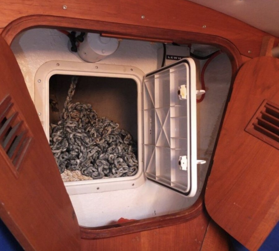

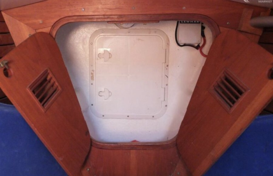

Dear Saskia,
I haven't build a watertight bulkhead but I remember seeing photos of a Swan 38 (Pizco) with an interesting intallation.
The forward compartment, enclosed by wooden doors, is around 170cm from the bow but I believe the rule is actually "within" 15% of LH, so it is not a problem. The LWL is about 130cm from the bow, so you can install it abaft the forward end of LWL.
Sincerely,
Michel
