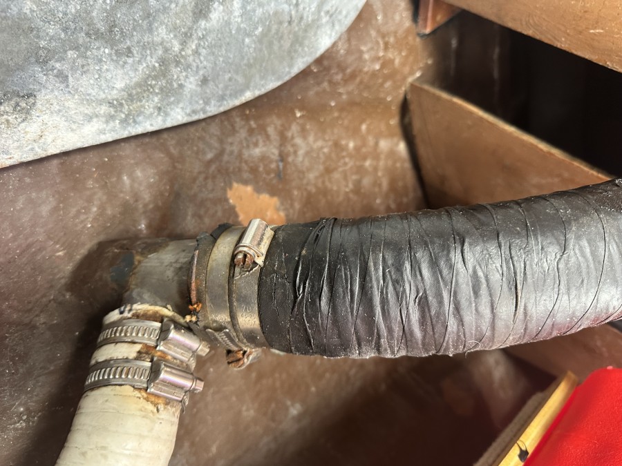

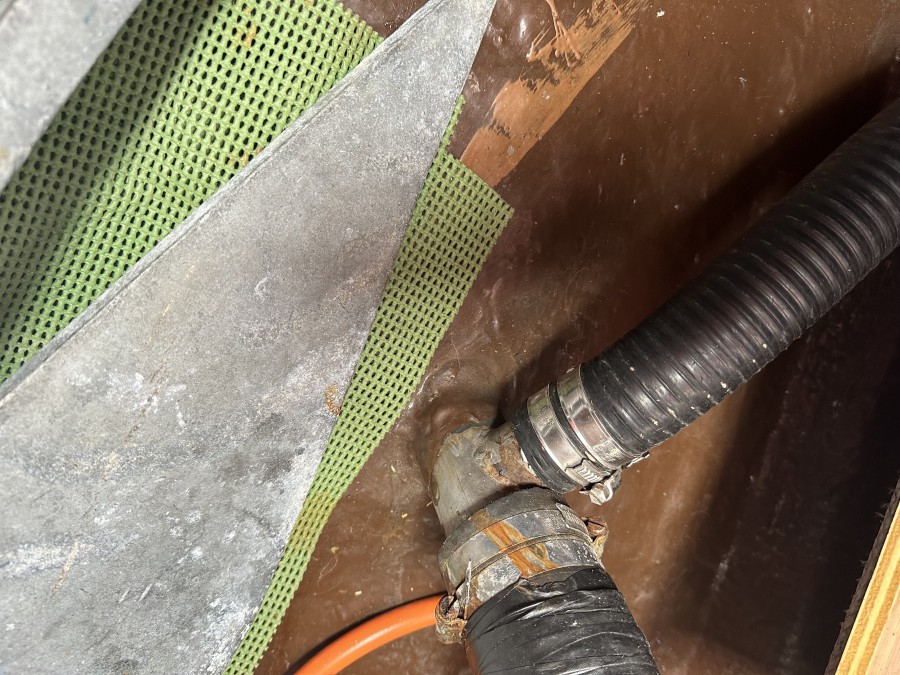

in my 47 I have cockpit drains as shown on the images. In my previous 38 I had drains with large valves.
I find it strange and maybe potentially dangerous that these drains are without valves. Or is this normal on a 47?

Dear Jan,
it's standard layout, and by the way it was the same, with no valves, onboard my previous S&S Swan 38 (hull no. 067)!

I find it strange, because when sailing it's under water. And all through hulls should have a valve. On the other hand, you would never close it, because it won't drain when closed.

Dear Jan,
we discussed this detail (valve yes/valve no) for years with Lars, and there are good reason to have it and good reason not to, so, happy I killed a job before your crossing!
