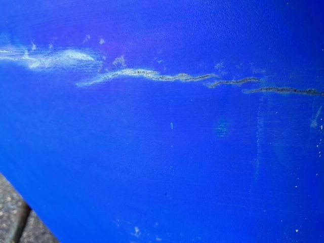

I am the lucky owner of Swan 37 #55, currently names Samphire, previously Chanchullo (for 7 1/2 years). She has always had a slightly crack at the front of the keel, which tends to slightly open when she is lifted.

could you please post some detailed images of the crack, and let us know if you have water coming in from the keel bolts?

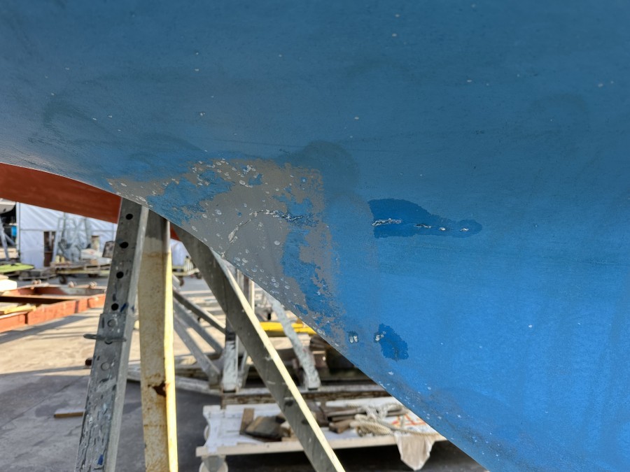

It is likely to be the typical "S&S Swan Smile" (please see example attached), which should not worry you.
Looking forward to seeing the photos, thanks.

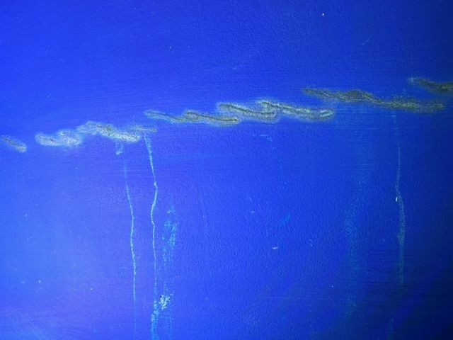

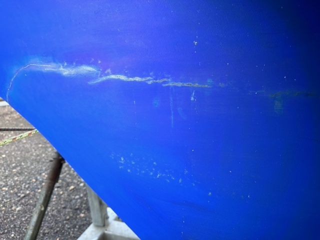

Many thanks for your prompt response. Please see photos now posted. I will trty and post some better pictures if I get the chance. There is a hairline crack at the front of the keel join to the hull on both sides, which slightly opens when she is in the slings. The crack is not getting noticeably worst, but there is some 'bleeding', suggesting some internal corrossion.

If it's an hairline crack should be the typical "S&S Swan Smile" and of no worry, bleeding is normal when the boat is on her sling, it does not mean there is corrosion, probably just a cosmetic problem, anyway, before dismantling the keel, very expensive job, why not getting an ultrasound check on keel bolts?
If bolts are still covered with original gelcoat that's a good news, it probably means the boat never went aground and the previous owners did not need to check the keel bolts.

It looks a typical "S&S Swan smile" and should be of no worry.
