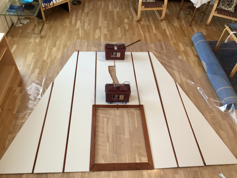

I'll agree with Martin, I used the same material from SVB about 3 years ago in our forecabin. We just removed the old lining off from the plywood. I decided to use those original plywoodpanels as their condition and fitment is perfect and their final shape is 3-dimensional when installed. This means that that possible tiny errors done when copying the original ones would show immediately.  I then epoxied both sides of the plywood parts with West epoxy just to waterproof them against possible future leaks. Just in case. Used stainless staples. The result is shown below.
IHe, 431 CAID
Just before final installation
