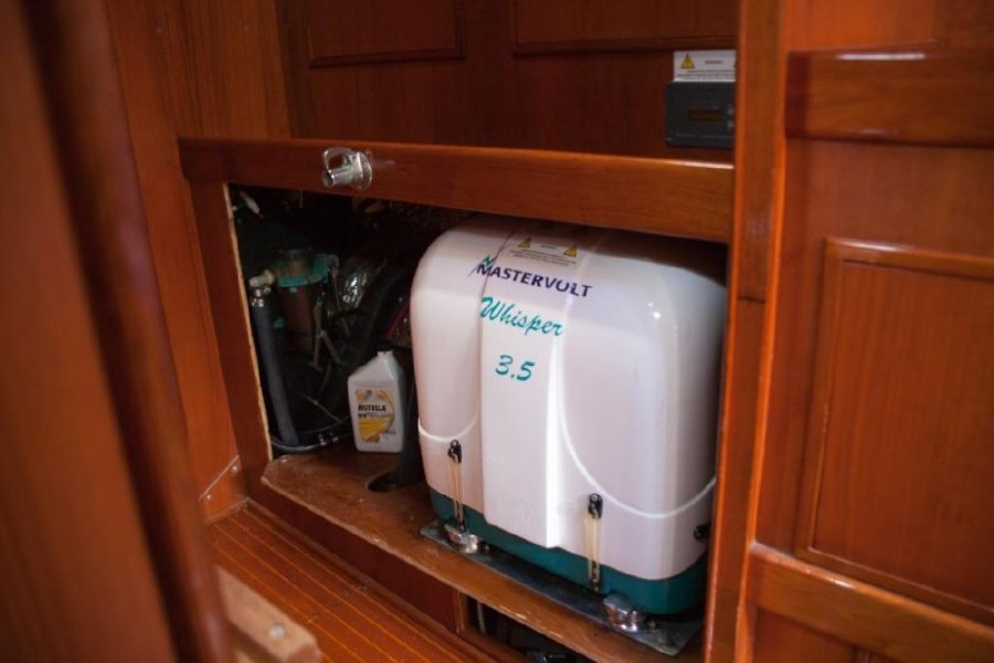

Swan 47/57 - "Till" had a generator installed under prior ownership. The drawers across from the forward head were sacrificed for the installation and replaced with a removable panel.
The generator is a Mastervolt 3.5 Kw single-cylinder diesel. See pictures attached.

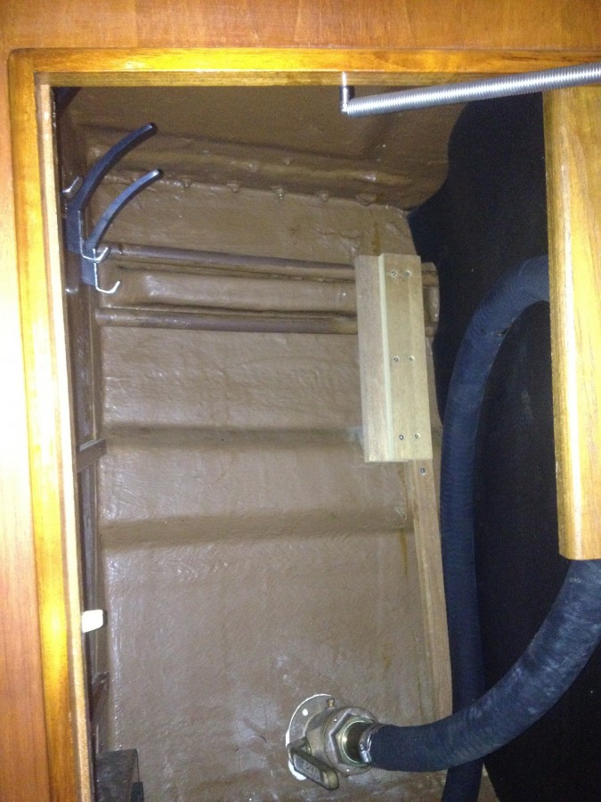

I will re-work the exhaust outlet by adding an elbow so that so much space is not lost in the hanging locker.
The fuel is plumbed from the starboard diesel tank.
The seawater cooling has a separate seacock next to the original toilet flushing water inlet seacock.
