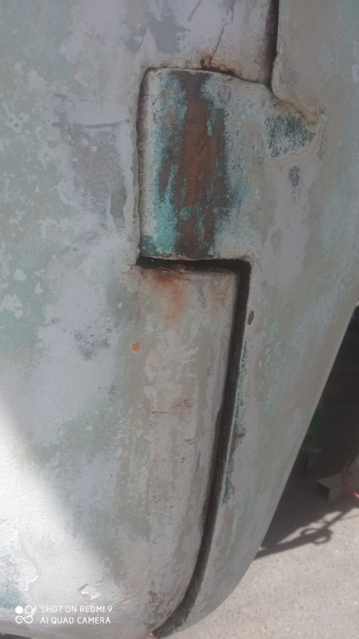

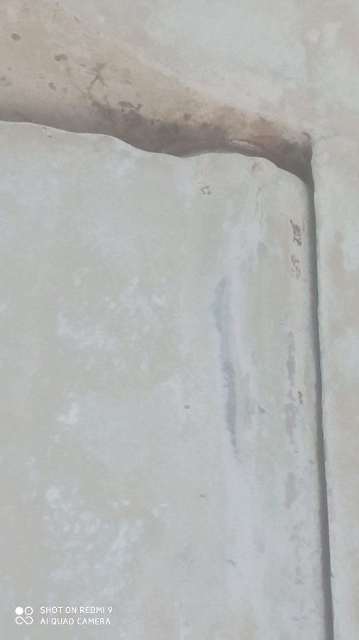

The rudder of Grampus has slipped down about half inch from its site.
Is It advised tò install a two parts washer of the right thickness?
Alternatively, Is there a different solution?
Thanks everybody

Oops, the slot Is about 1/4", 6 mm

the correct job would be to dismantle the rudder and get a (preferably bronze) washer of the right thickness. I am not sure a two parts one would stay in place.
Dismantling the rudder will give you the chance to change the bearings (delrin of course) too.

Thank you for your suggestion. Yes, indeed a two parts washer would probably be too thin. I will discount the rudder next winter and follow your indications.
