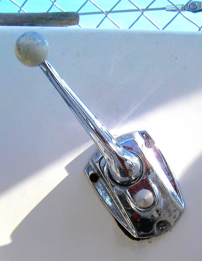

Hello Everyone,  Serafina (38/039) has the usual cockpit combing-mounted throttle/gear lever which I think requires serious maintenance or even replacement.  (I can no longer select neutral with the little button which complicates close quarters manoeuvring!).  My question is has anyone succeeded in accessing the unit either via the lazaratte or aft cabin.  If the latter it seems I'll need to take half the boat apart to get to it!
Any thoughts most gratefully received.

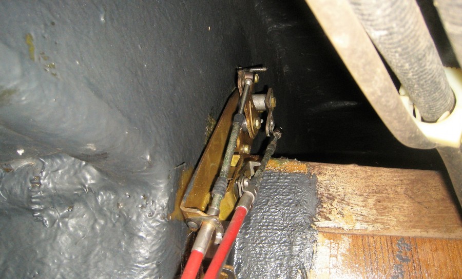

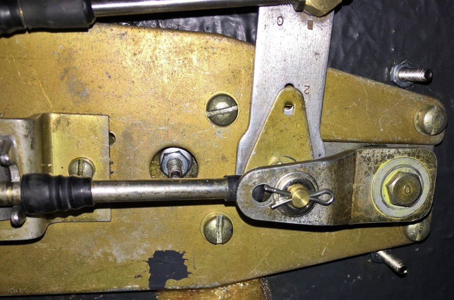

The lazarette is too small for me, so I had to work without eye contact, looking at these fotos.
If I remember right, I
1.) detached the back plate from the control head (four screws), and released the cables from the plate (clips).
2.) detached the control head from hull (three screws).
3.) detached the cable wires from the control head clutch lever and throttle arm.
The control head was in need of thorough cleaning and re-greasing.
I flushed the cables pouring WD-40 through a length of silicone tubing tightly fitting on the cable mantle (tube hanging from workshop ceiling). I moved the cable wire at the other end. After the WC-40 run out clear, I blew it out with pressure air and poured CRC-6-66 through the cable.
These procdures had a great impact on gear and throttle control function.
Attached a couple of fotos.
