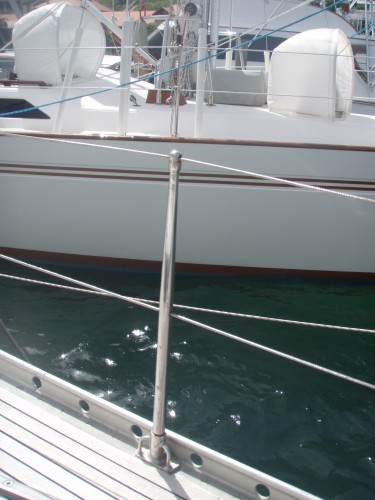

Two stanchions on my Swan 47 are damaged. One has a sizeable crack, the other buckled. What do you sugegst about replacement? I have attached a photo so that you may guess at who originally made the stanchion. My boat was built in 1979. We are currently located in the US Virgin Islands.
Best regards,
Milo
