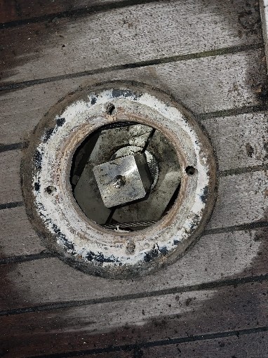

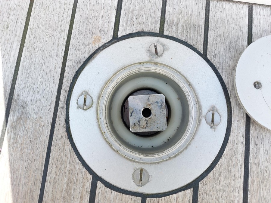

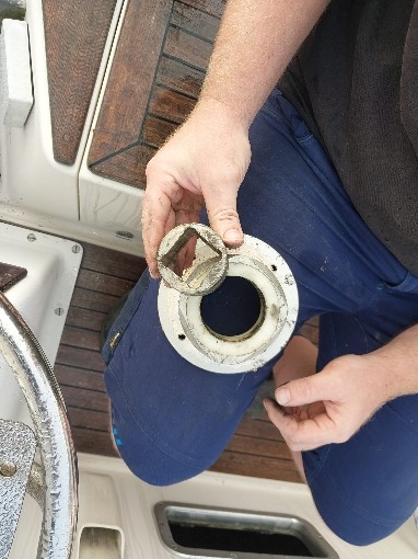

thanks a lot! Actual it was the metal bearing at the upper rudder stock which was worn out by app. 0,7 mm  (could be that it was like this for a longer time and we just didn't notice it). As I wrote: new engine, new vibrations, new noises. We opened up the two half rings underneath the cockpit floor in the aft cabin and then the bearing and the outside ring could easily be pushed out. We had a new metal bearing made and put it back in space vice versa. Very easy - no big deal.

Before
rudder stock opened
metal upper bearing renewed
