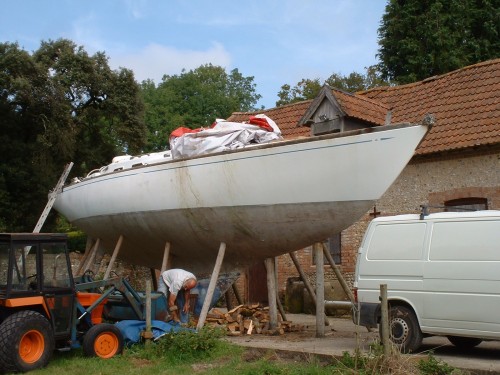

Good question, buy best or restore, we are 75% through the restoration of a Swan 40 (#29) which had been neglected for a number of years. We found her in a farmyard in Dorset where the previous owner had started to “restore” her but had left many bits half disassembled. Anyway she was pretty rough but I fell in love with the shape, and much more importantly so did my wife, so we bought her and so far have spent many hours plus ten’s of thousands of pounds getting the structure sorted properly.
So far we have had a full hot vac osmosis treatment, topsides stripped back to the gel coat and then a quality 2 pack paintjob of the hull and superstructure. We have also overhauled the engine including new bearers and stern gear etc, all hatches / windows out, new mast and rigging, sails, electronics etc.
Would I have done it the same way with hindsight, yes probably, I am pretty handy and have done much of the work myself but I think you need to have plenty time and cash to throw at the jobs where it counts. You will eventually end up paying as much as if you had bought a “good one”, but we didn’t see any “good ones” which wouldn’t have needed as much work within 3-4 years, so we thought you would end up paying twice.
If you go for the restoration i think it’s a good idea to have a plan to get her sailing in a period you are happy with, if it drags on and you don’t get her sailing you may become disheartened and then it’s not fun anymore. For me this is a better judge of how viable a restoration is than a purely monetary one.
Well best of luck what ever you choose, and if you need some information please don’t hesitate to get in contact.
Jason
