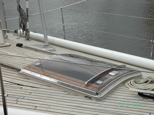

Hello Leif,
I am sure that Lars has a better answer to you. However I venture to share with you my expereince about a leaking fore hatch. I rebuild it alltogether using the form of the old one to have a new Lexan baked in an oven and shaped to the right form. Furthermore, I replaced the wooden frame surrounding the Lexan with Stainless Stell frames. These frames are formed as to dirext the water flow out. No water is thus retained. It has been perfectly dry for 4 years now. I even replaced the wooden top handle with a stainless steel one.
See attached pic.
Cheers/Philippe

Many thanks for your comments. It was very helpful to see the photographs and to learn from earlier discussion.
