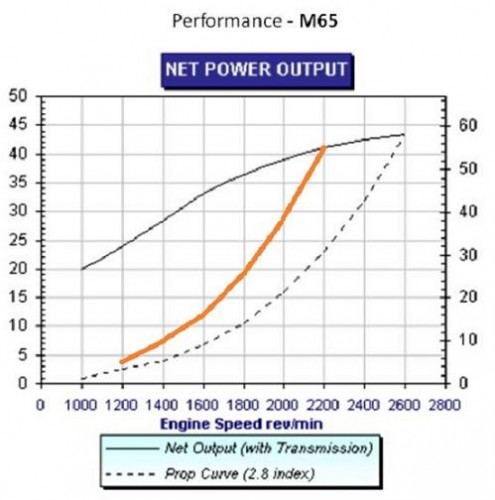

John, you inform that the maximum achieved rpm is 2200. The nominal maximum is 2600 rpm for this engine, and this means that the propeller curve and fuel consumption given by Perkins do not apply. I have plotted the new propeller curve corresponding to 2200 rpm max in red on the appended diagram, the consumption is then 1.79 times higher at the same rpms. I would suggest that 6 knots is reached at 1600 rpm.
Generally it can be said that the lower the engine rpms the less fuel is consumed per mile, but idling should not be used, the consumption just to keep the engine running becomes dominant. Also, Perkins recommends that at least 25% of the full power needs to be used in order to prevent the engine from collecting soot, for John this conveniently is 1600 rpm.

PS Unable to add diagram, generates error message
06 April 2014 - 20:22
File size is 44 kb, but refused to upload

Dear Lars. FYI on my Perkins MD65. I went for the first run out this session with the engine and in flat water. At 1600 revs 6.0/6.2knts. 1800 revs 6.5/6.8knts the stern is just touching the water. I then opened up the throttle to max possible 2400 revs 8.1/8.3knts. At this point the stern was under water to the extent that the exhaust discharge was going under water at times. (I have a non return flap fitted)
My normal cruising revs are 1800 which returns approximately 2.5 litres per hour. As stated before, anything above these revs gives little extra speed at a large increase in fuel consumption.
13 April 2014 - 19:21
#19
Dear John
Thank you for the information
You are right that the fuel consumption rises very steeply at higher rpms, with very little increase in speed.
It can be estimated that the engine output at 1600 rpm is about 17 hp, and at 1800 rpm 24 hp.
